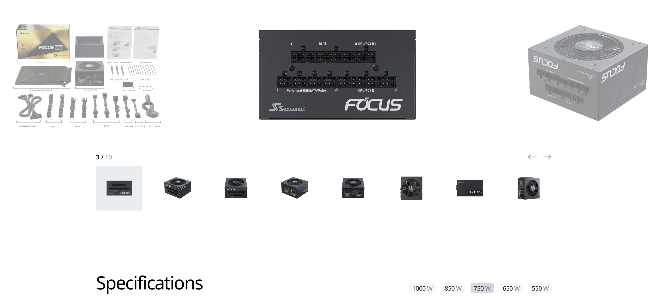

nub question.
the case for connections says 15pin and 7pin. what is that and where do i plug into the psu
seasonic focus gx750 (NON 3.0atx) is what i ordered
https://seasonic.com/focus-gx/
not sure where to plug them in psu :grimacing:
*update
hm
SATA Data Connectors
A SATA data connector has 7 horizontal pins, four pins arranged in two pairs for data and 3 ground pins. One end (the end that connects to a storage device) may be angled to save space.
A small form factor version of the SATA data connector, known as mini-SATA or mSATA connector is designed for use with smaller, power-constrained devices such as laptops and tablets.
SATA Power Connectors
The SATA power connector has 15 pins and supplies +3.3V DC, +5V DC and +12V DC. SATA power cables are often paired with a 4-pin Molex LP4 connector, which connects to a computer’s power supply.
Why does a SATA power connector have so many pins?
The 15-pin SATA power connector replaced the 4-pin Molex connector. Why the much greater pin count?
Support for three voltages (3.3V, 5V and 12V).
Avoids confusion with the 7-pin SATA data connector.
Additional ground pins to support device hot-swapping.
Advanced features such as delayed spin-up for mechanical drives.
