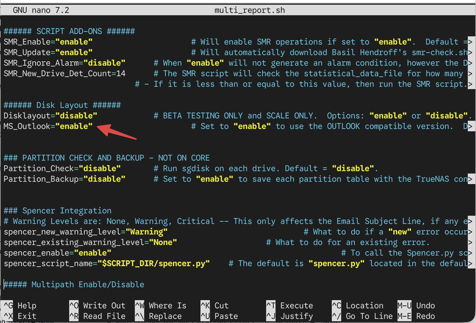

The current default configuration seems to have an issue.
Exiting Joe's SMART Drive Self-test Script
Collecting Multi-Report Data...
cat: case_email_outlook_snippet.html: No such file or directory
Using sendemail.py
I fixed the issue by manually adding MS_Outlook="disable" in the multi_report_config.txt file.

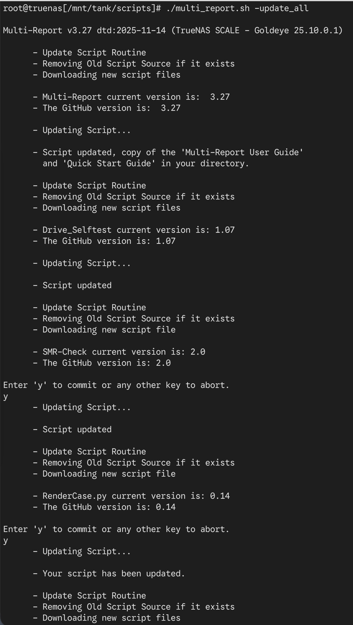

3.27 + the latest render_case.py combination has this issue; it started yesterday.
Yep, yesterday i pushed the new render and i was using an f-string concatenation not supported by the TN python version (i was testing on my pc and i have a bit higher version there -.-), also timing was still not so good, i was too fast and MR wasn’t ready, me and Joe are working together with a huge timezone difference :joy:

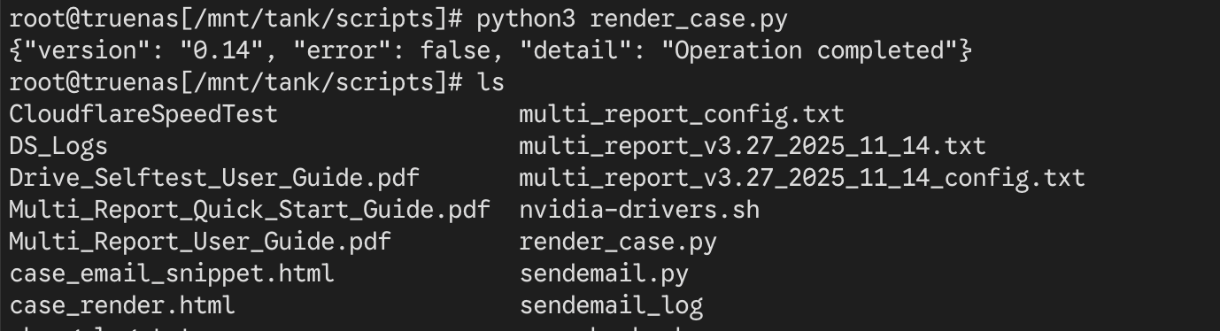

BTW, 0.14 should fix the problem render side, can you try to launch the render from the MR folder? python3 render_case.py and see if error persists or if the files will be generated?
everything seems working fine render.py side (you can delete both case_email_snippet.html and case_render.html files if yo want), if you use the -dev switch in the multi report ./multi_report.sh -dev are you still encountering issue?

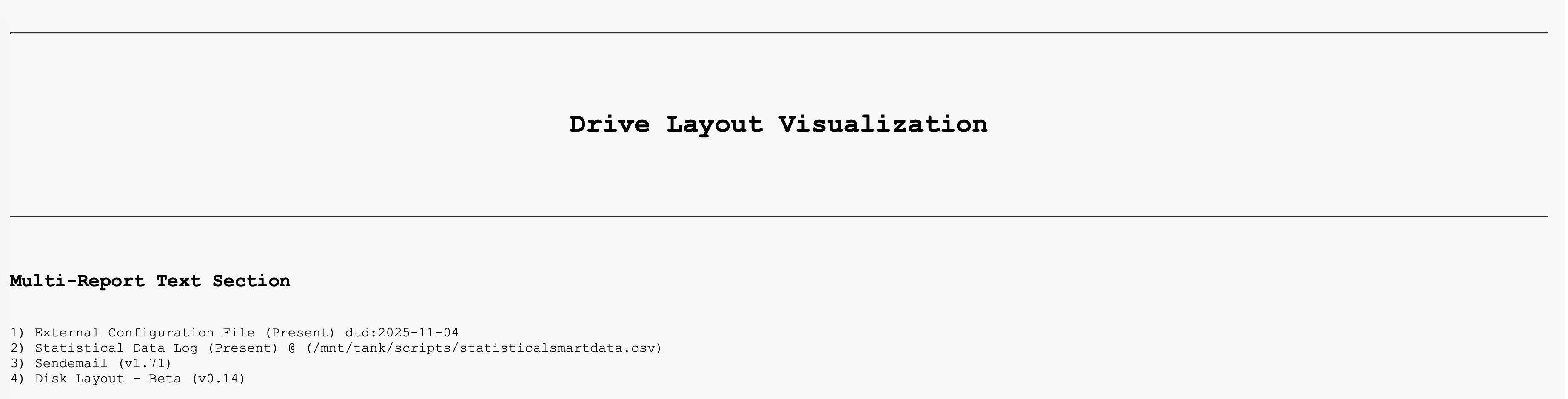

I have grabbed the latest version here Multi-Report/multi_report_v3.27Beta7_2025_12_01.txt at main ¡ JoeSchmuck/Multi-Report ¡ GitHub and i have layout.. quite odd

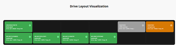

The Disk Layout purpose is to graphically map the location of your physical drives. If you have removable drives, when you replace a drive, the script should automatically update. The purpose is to help you physically locate a drive, NOT to provide you a lot of drive data, you have the other Multi-Report charts for specific data. We will not change what we present unless it makes sense to do so.

3.28 and co. - what a lovely job ! The disk layout c/o this URL is particularly useful and it has laid to rest a particular worry of mine (how to identify which disk has failed). I note that the slot’s occupant is defined by the disk serial number rather than the disk bus ID (sda sdb sdc etc.) which is great, seeing as the latter seems to change when reboots occur.
