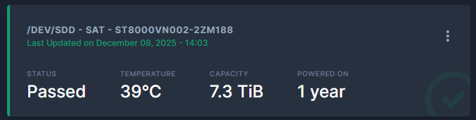

inside the container to start a scan:
/opt/scrutiny/bin/scrutiny-collector-metrics run
and it works almost fine : command timeout = 1 (passed). :grinning_face:
Best regards
Ronald
