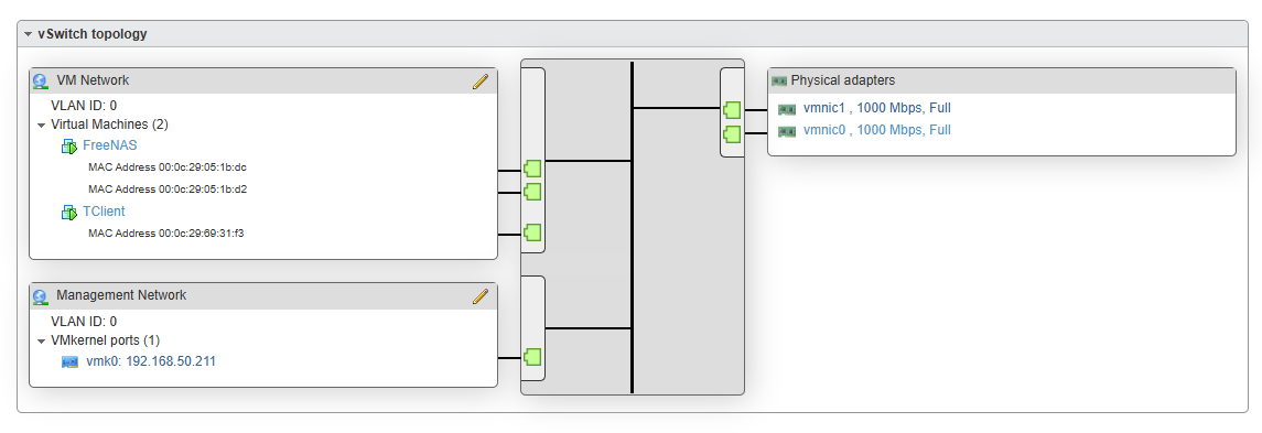

I suspect the MAC address you see inside the jail with ifconfig is also used by some other VM connected to the same vSwitch. Or by the TrueNAS host but you already ruled that out.
The host complains that the MAC address that it saw on the epair (the host end, named vnet0.1) was suddenly appearing on vmx0 - which goes to the vSwitch …
Hmm I can’t see anything, here is the switch topology
Anychance it’s residual config on vmx0? I didn’t see any assigned mac address to remove when executing your original steps
Maybe something with those dual uplinks. Are they connected to a managed switch and run LACP?
Topping it off jails can’t reach the default gateway again so back to square one.
I did create a new jail and shut off the old one for now so I’m working with a fresh jail on version 13.5 to isolate existing config as an issue. I still see the MAC address log but the DAD one is gone indicating that was an issue on the original jails config (I think unable to disable ip6 autoconfig for some reason). Hoping I can transfer files from original jail or use the settings that work from the new one to get the old jail functional. Worst case I can abandon the original and rebuild the media library metadata (plex)
Uplinks are the ports on my server board, afaik designed to both be connected https://www.asrockrack.com/general/productdetail.asp?Model=E3C246D2I#Specifications

Unplug one port please and test again.
no change with the second port unplugged.
edit: witht he logs at least but the jail connects correctly so it seems ytou are right in that it relates tot eh dual uplink. It has never been an issue previously but I guess truenas upgrade must’ve changed that
