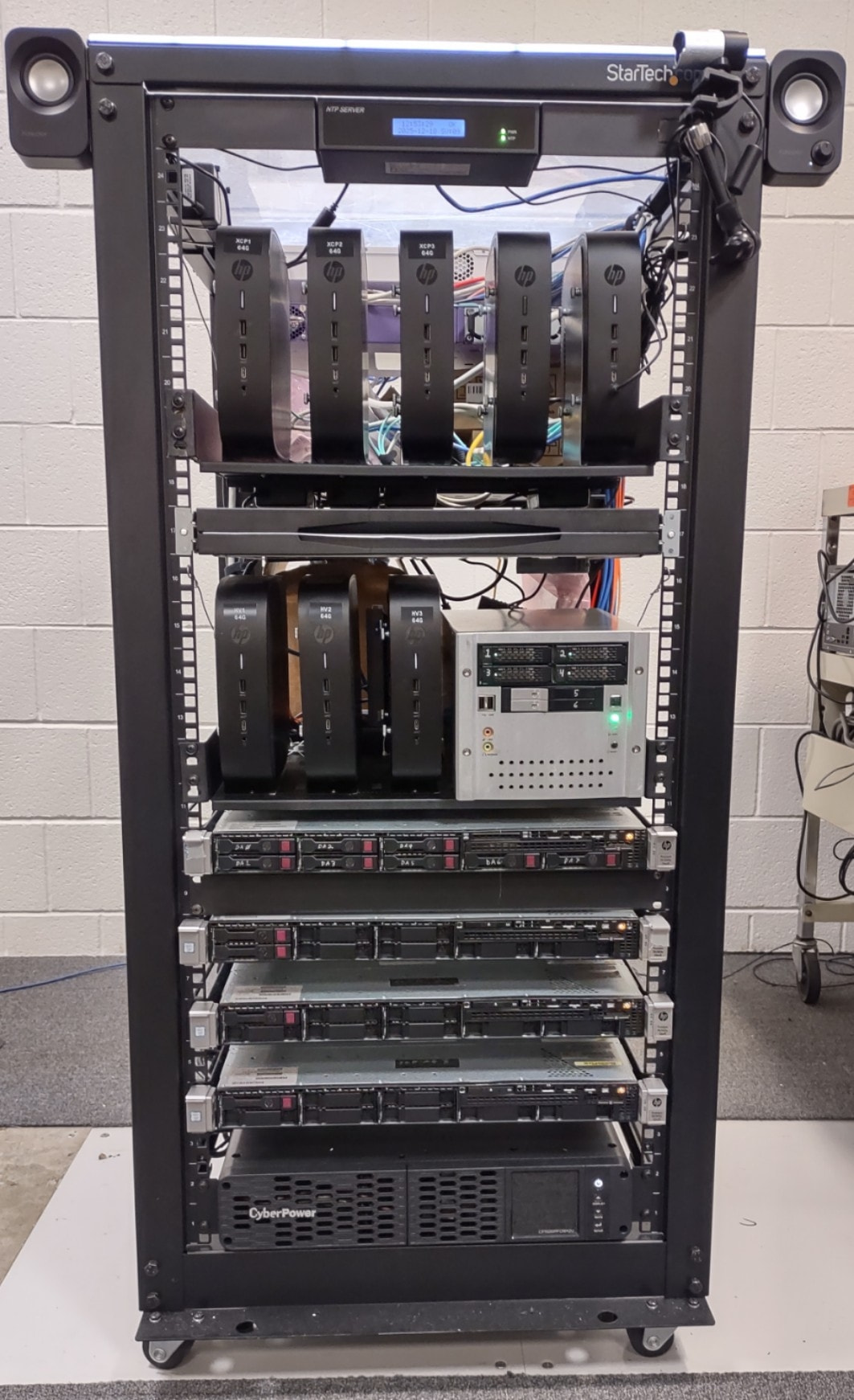

NAS is in the silver chassis, the HP at the bottom are mostly taking up space, no UEFI so their value is quickly decreasing for everything I want to try and do, and the HP p420i is also giving me problems with newer Windows OS. Probably should sell off the DDR3 and recycle the rest.
