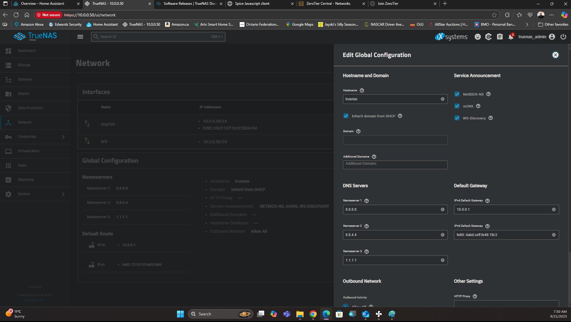

Global Configuration
Nameservers
Nameserver 1: 8.8.8.8 Nameserver 2: 8.8.4.4 Nameserver 3: 1.1.1.1
Default Route
routerIPv4:
  • 10.0.0.1
routerIPv6:
  • fe80::7213:1ff:fef5:9d6f

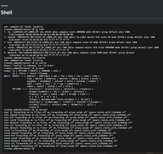

Can’t ping either? Gonna need a screenshot of your networking page + outputs of ‘ifconfig’ and ‘ip link’.

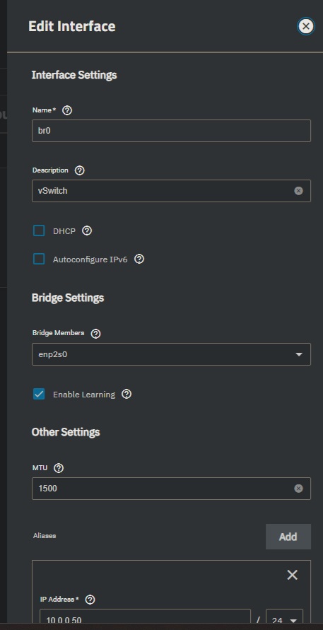

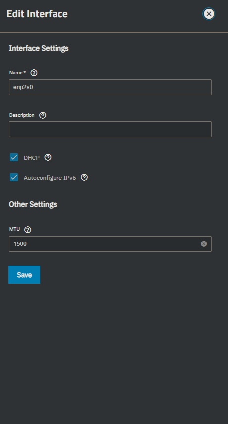

here’s the shots
Alright, first issue I see - you have an IP set for enp2s0, which is a member of br0. If you’re going to have a bridge setup, then you have to remove the IPs from enp2s0 and apply those under br0.
@Stux has a video on setting up a bridge if you’d find it helpful - though the UI may have changed ever so slightly since its release, the key points are the same:
