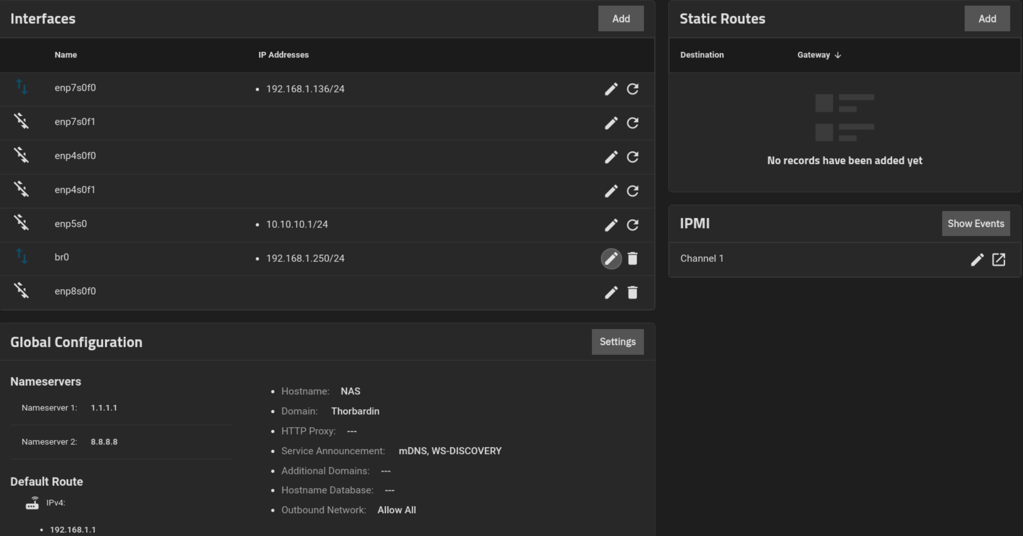

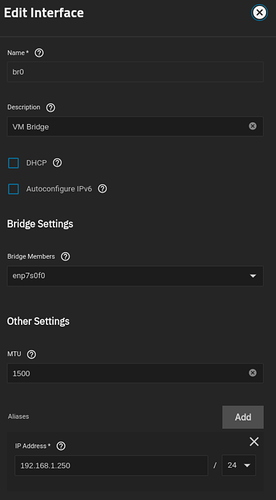

How is the bridge interface configured?
If you’re able to can you send a screenshot of the full network page, would be very helpful.
Hmm… can’t seem to post images here, so…
And it won’t let me post links either?
drive(dot)google(dot)com/drive/folders/1fw3ni479m8dWffN8dGXn5ui60YmGOsae?usp=sharing
I forget the new user perms are a little restrictive, no worries.
Pasting here for reference:
TrueNAS should have warned you about using overlapping aliases.
If you don’t have an explicit reason to be running this address (192.168.1.136/24), try disabling DHCP / removing the alias from your physical interface, leaving your existing configuration in place for the bridge.
