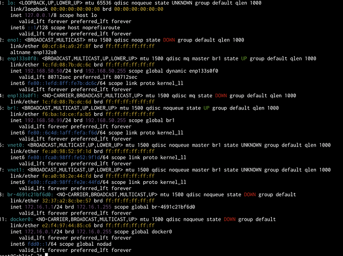

Please post the output of ip a on the TN server?

enp133s0f0 having it’s own IP when it at the same time is part of br1 is unexpected. I would start removing the IP from the physical NIC.

I rebooted this morning, but everything else was the same. Tried several reboots. Nothing seems to work. I have console access, I have tried removing and resetting all network devices too.
I don’t know about removing and resetting, I just recommended that you remove the IP that is currently linked to your physical network interface, since that’s an invalid configuration given that the NIC is a member of br1.
