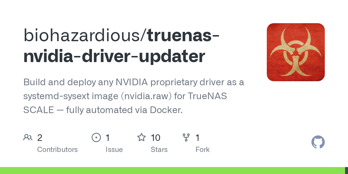

Just since this thread is getting more interest with the 5060/Ti GSP firmware bug, I’ll leave this here as a community-created resource:
I don’t have an impacted card so I can’t personally confirm the problem is fixed this way.
Hi all,
Currently i have Nvidia RTX Pro 2000 Blackwell on my Truenas. which have GSP bug. That’s why i created this script and trying to keep up to date. Most probably it will solve the bug with 5060 as well.
I am open for every feedback, if you got any problem drop an issue on Github so i can check what i can do. :sign_of_the_horns:
Hey everyone,
I tried the updater by Biohazardious and can confirm it completely solved my issue with my RTX 5060Ti 16GB.
I was running TrueNAS SCALE 25.10.4 (Goldeye), and the bundled NVIDIA 570.172.08 would detect the card in lspci, but nvidia-smi always returned “No devices were found”. Patching the NVIDIA driver to version 595.84 via the updater fixed the issue!!!
I was on the brink of despair after buying the GPU very recently, so I just wanted to create an account here to say thank you @Biohazardious for this wizardry (I am a complete newbie). It saved me a lot of frustration! :sob:
Hopefully this helps anyone else running into the same issue with the RTX 5060Ti on Goldeye.
Yeah, big props to @Biohazardious for this - I’ve directed several people with the impacted cards to that fix. The fix was upstreamed by NVIDIA into their later drivers, which are in TN26, but obviously with that still in BETA stage it’s not for everyone yet.
This is a good skeleton for the future as well - since NVIDIA updates their drivers far more often than we’ll build them, if they (eventually? ever?) release the Super variants on the 50-series cards, this would be a way to wedge the 610.xx or whatever driver is required by them into TrueNAS - or continue to land an older Pascal/Volta compatible release (provided you don’t need any of the new functions!)
