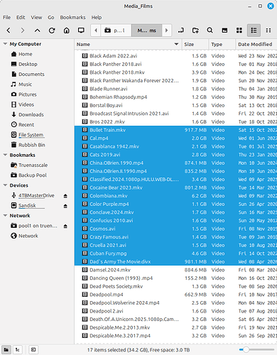

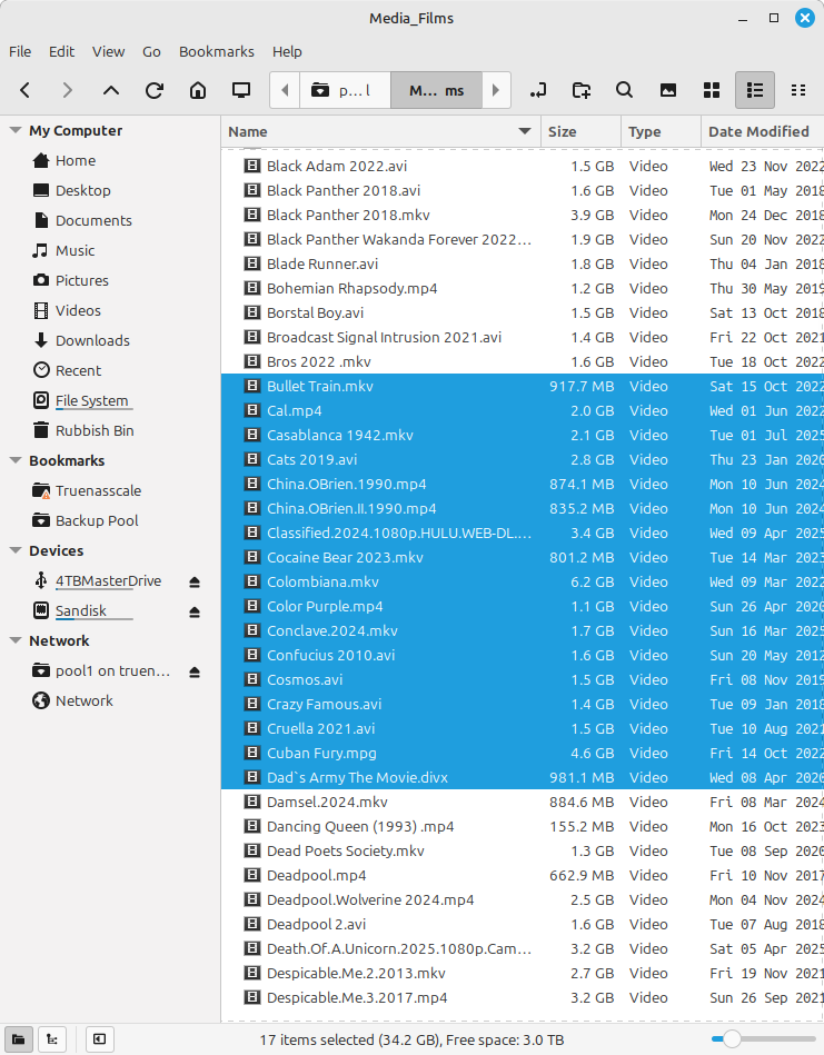

View of Media_Film User dave ( via Linux Mint )

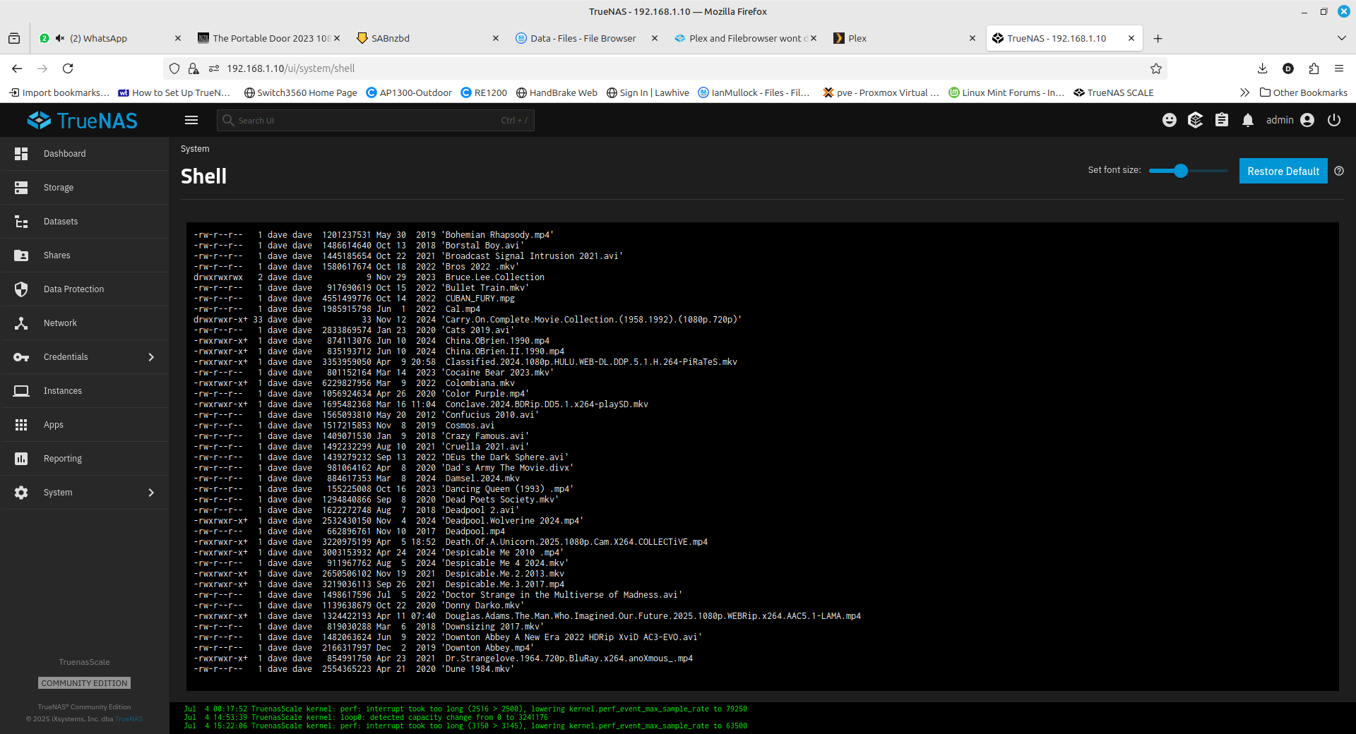

View via Shell User Admin on Truenas Scale
I see Casablanca shown in the User view from my desktop but no in the Shell listing ls -l
How curious…!
More investigation… as I say have changed nothing been working fine upto Jun 12 last film Ghost does catalogue…!
then I engaged the ZFS ditty , no errors no flames or grinding noises.,… and now here we are ?
So User Dave sees the missing files… Admin on Truenas cant…?

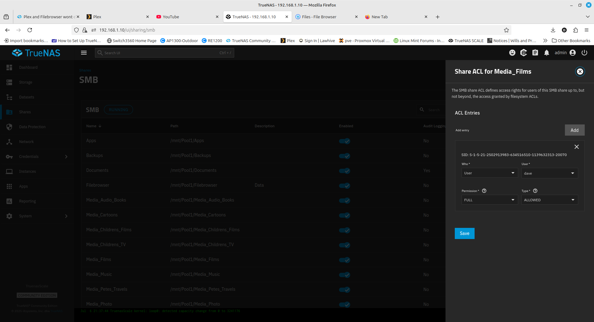

This is interesting. I suspect that the files are not visible to the apps user which is probably running Plex, emby and filebrowser.

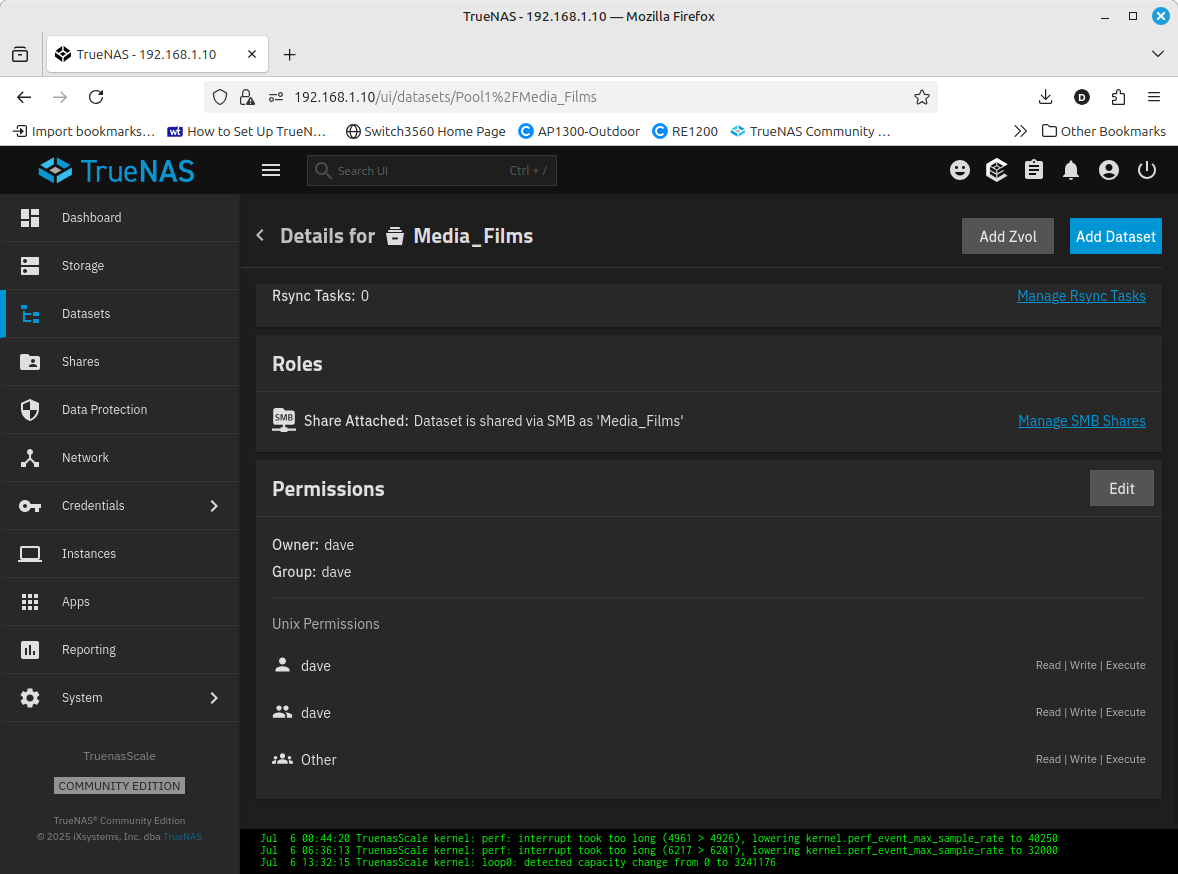

For the dataset that these files are in can you share what the permissions are?
Use the instructions below to get to the current permission settings.
Instructions from the docs on how to get to the ACL info
Basic ACL permissions are viewable and configurable from the Datasets screen. Select a dataset, then scroll down to the Permissions widget to view owner and individual ACL entry permissions.
To view the Edit ACL screen, select the dataset and click Edit on the Permissions widget, or go to Sharing and click on the share widget header to open the list of shares. Select the share, then click the options icon and select Edit Filesystem ACL.

I have logged into Shell as Admin and Root and new files are NOT visible in the Dataset Shares, (re screen shot Casablanca film)
Using a PC and viewing the share via my linux mint, I can see ALL files new and old.
I also noted that the User Plexname had its password changes 30 May this year, now its something i would never go into so what has changed that arbitrarily?

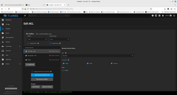

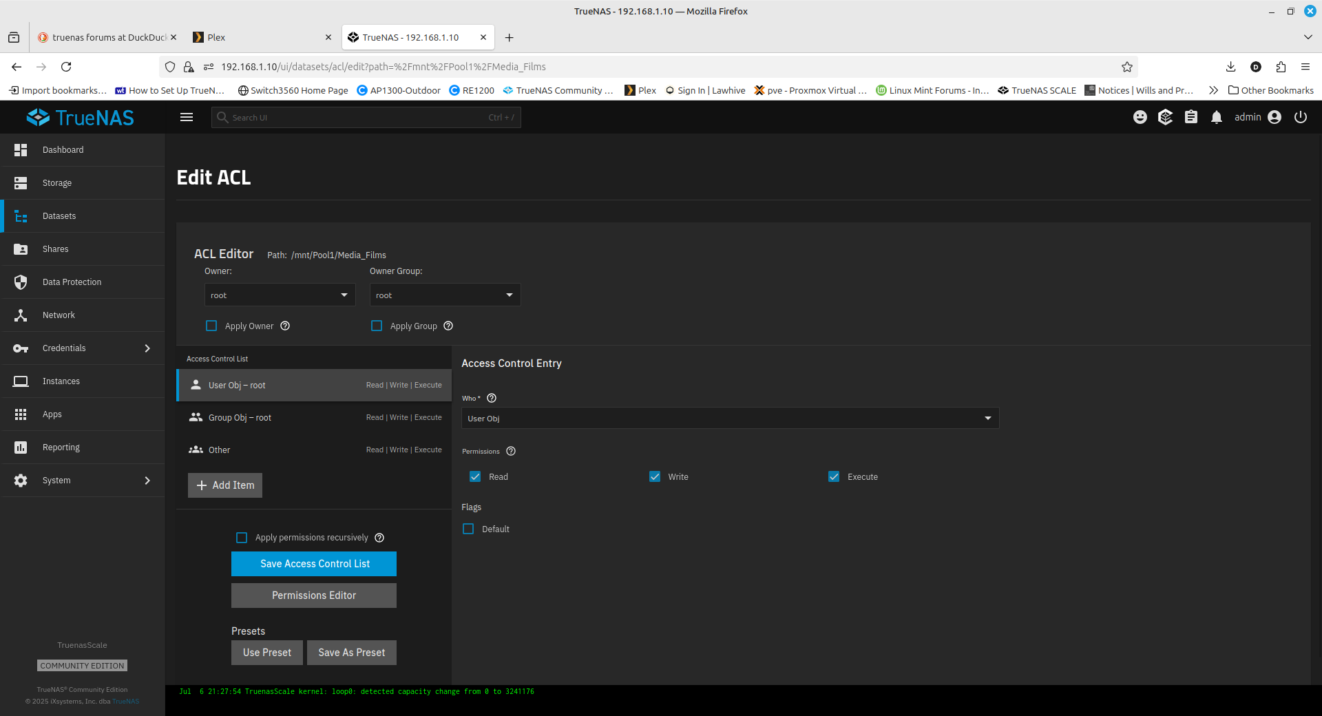

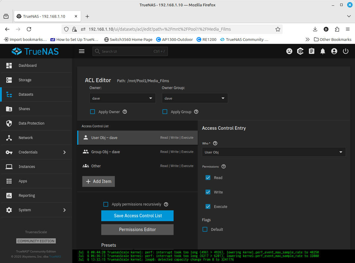

Here is a view of the ACL records
I cant quite get my head around the fact in the share view via PC I see all files in the dataset folder, yet within Shell using ls -l as Admin or Root to view files and their permissions , "Casablanca " is invisible.
As the Apps Filebrowser and Emby are similar I can only conclused a Global change has occured, as Ive not changed any ACL or permissions myself.
My permissions may not be absolutely correct but have worked these past 5 years or more since previous Freenas Truenas Scale upgrades…

Deleting my ACL settings to the Media_Films Dataset and applying POSIX open
Save…
And miraculously, my Plex now sees ALL the files in the Media_Dataset .
Im onto something here… now I have no rights to the share…another trip to the console and now those rights are restored…

Yeah I don’t know enough about zfs to say if upgrading the pool was what did this or not.

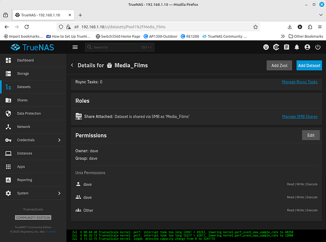

It does look like the user who runs the Plex application doesn’t have access to the media dataset. That user is the apps user (usually Uid 568 and Gid 568, although make sure in your system). I would add them to the dataset to see if that fixes it.
In the third photo click add item, on the right select user and select the apps user. Make sure it can read, write, and execute. It is sometimes also called modify in the basic settings. Do this again for the apps group as well.
As for the filebrowser dataset you can do the same thing as well. I am a bit confused though since I thought for filebrowser you have to add external storage pointing to the datasets you want to have access to.
Been a few days now, ( and far too hot )…In an effort to keep my Plex going , i set the attribute Everyone to RWX, meaning a free for all…
Now I after many You tube and reading, I find this permissions set worked
User Obj – dave Read | Write | Execute
User – apps Read | Write | Execute
User – plex Read | Write | Execute
Group Obj – dave Read | Write | Execute
Mask Read | Write | Execute
Other Read
User Obj – default – dave Read | Write | Execute
Group Obj – default – dave Read | Write | Execute
Other – default Read
