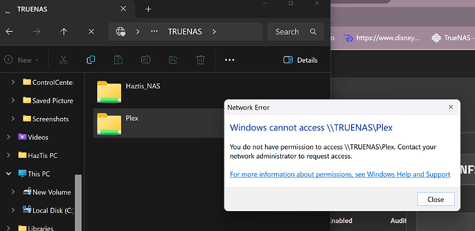

I can see the folders in my Windows PC via my network but I don’t have the permissions to access them and add files to the folders etc.

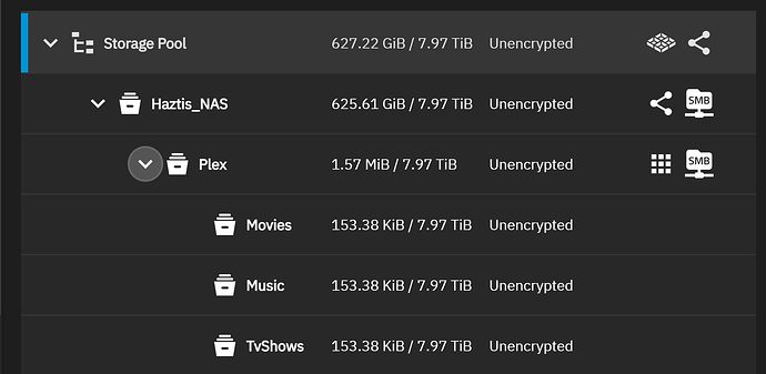

These are my datasets:

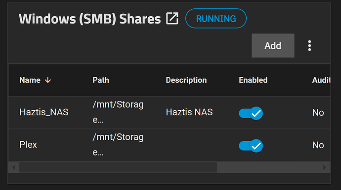

These are my shares:

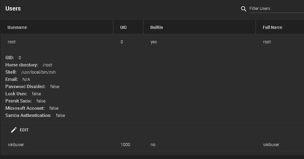

If you look under the Users tab and then ROOT, you should see that SMB sharing isn’t allowed.
Screenshot from TrueNAS Core 13 but Scale should be similar. Root showing Samba Authentication : False. I have a separate user SMBUSER set up that owns my child dataset set up for SMB sharing. Having ROOT as owner may be the problem

Not sure why I can access the Haztis_Nas folders but not the plex ones.
Can you explain how to grant access to the Plex folder. I think once I have access to the Plex folder in Windows I can then move media across and Plex will finally work for me.

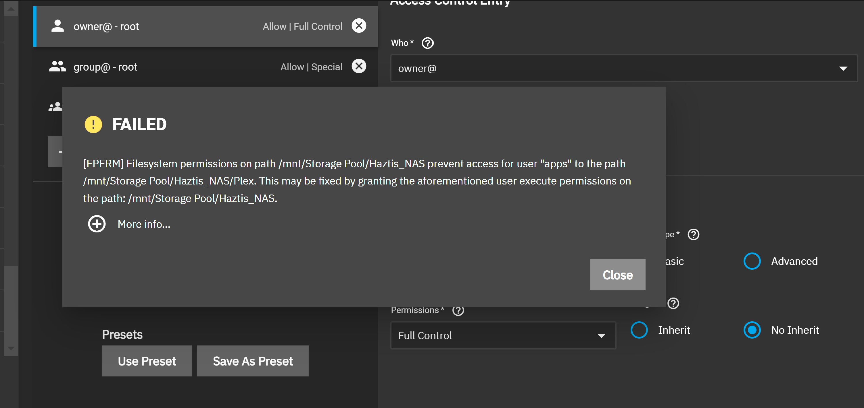

Thank you. I did trhat and when I set them the same I got this message:
Not sure what to do.
I’m genuinely trying to help here and not just be snarky, but did you read the error message and try to do what it tells you to do?
Yes, I did and I have been trying everything for the last 2 days.
I cant figure out where I have gone wrong. I am sure it’s something simple but not sure what.
Do you know how to do what the error message is asking, please?

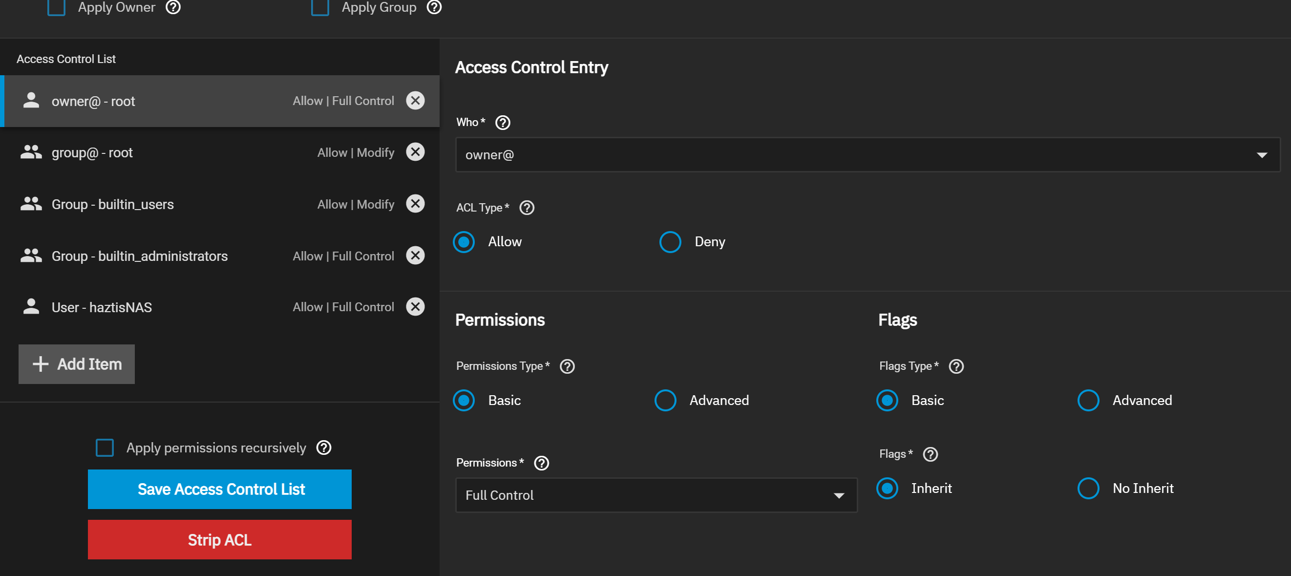

Add an ACL entry on /mnt/Storage Pool/Haztis_NAS to give the “apps” user at least execute permissions (you can select Full Control in the basic permissions editor)

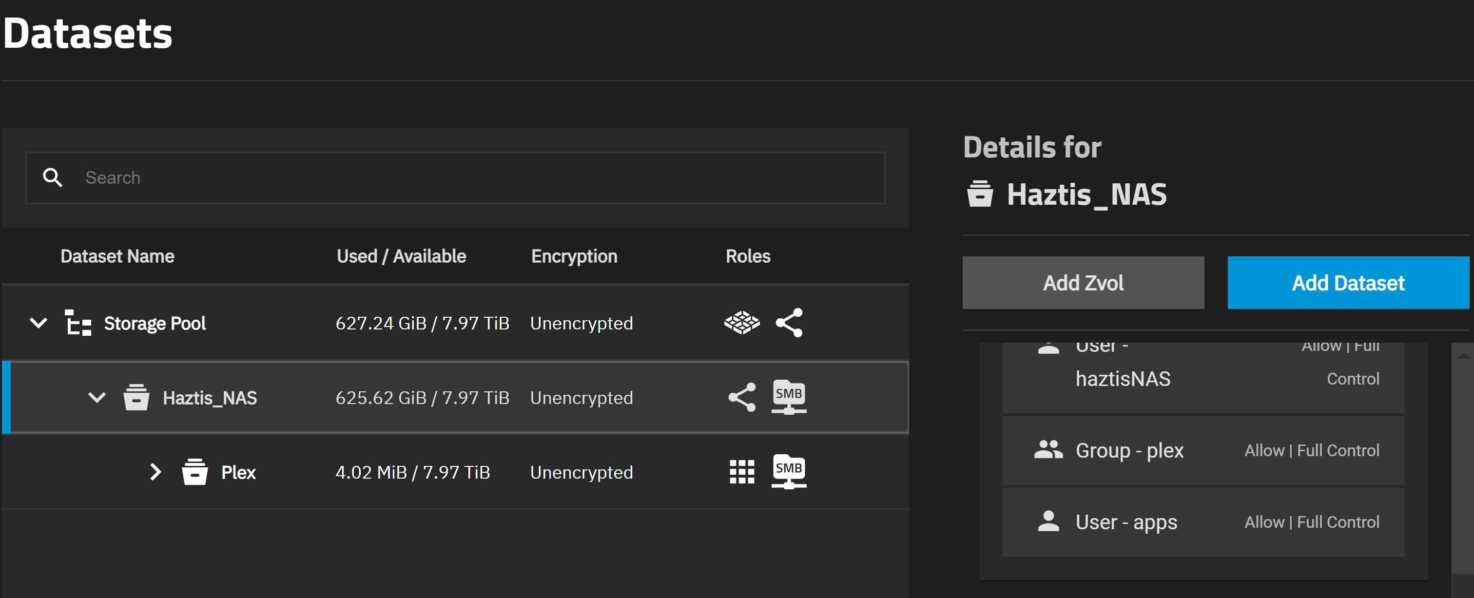

I did as you suggested.
But i still can’t copy anything to the plex folder in windows.
What are you trying to show with the above screenshot? You have Haztis_NAS selected and we can’t fully see all the Details on the right?
Also, did you try rebooting both machines, TrueNAS and Windows?
I was trying to show that I created the User - Apps as DjP-iX suggested as you can see on the right of the screenshot.

Two things to check:
1: Which user are you logging into the SMB share on Windows as? That user needs to have permissions on both Haztis_NAS and Plex.
2: You added apps to the parent dataset, but did you do so recursively or did you then go and manually add an entry for apps in Plex?
