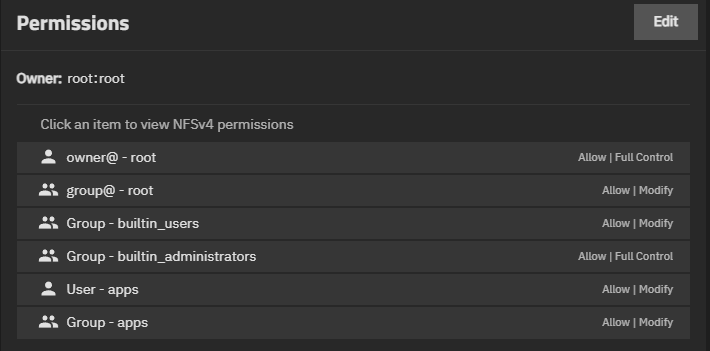

To make sure that it isn’t a permissions issue. I tried changing the owner and owner group of my Plex Media dataset to both be apps. Plex was able to see the next level of folders after Plex Media (anime, movies, music, etc.) but it still wasn’t able to see or access the media inside.
edit: I have just tried deleting and reinstating the apps group permissions on the Plex Media dataset. Now Plex can see all the files inside my ‘Photos’ folder, but all other media in every other folder is still inaccessable. I also still can’t access these photos in the SMB share.
Did you apply the change in permissions recursively? That you could see the folders now, but not the contents of the folders suggests this might work.
This was it! I reset my windowset permissions and then applied them recursively to all child datasets. Thank you so much!
