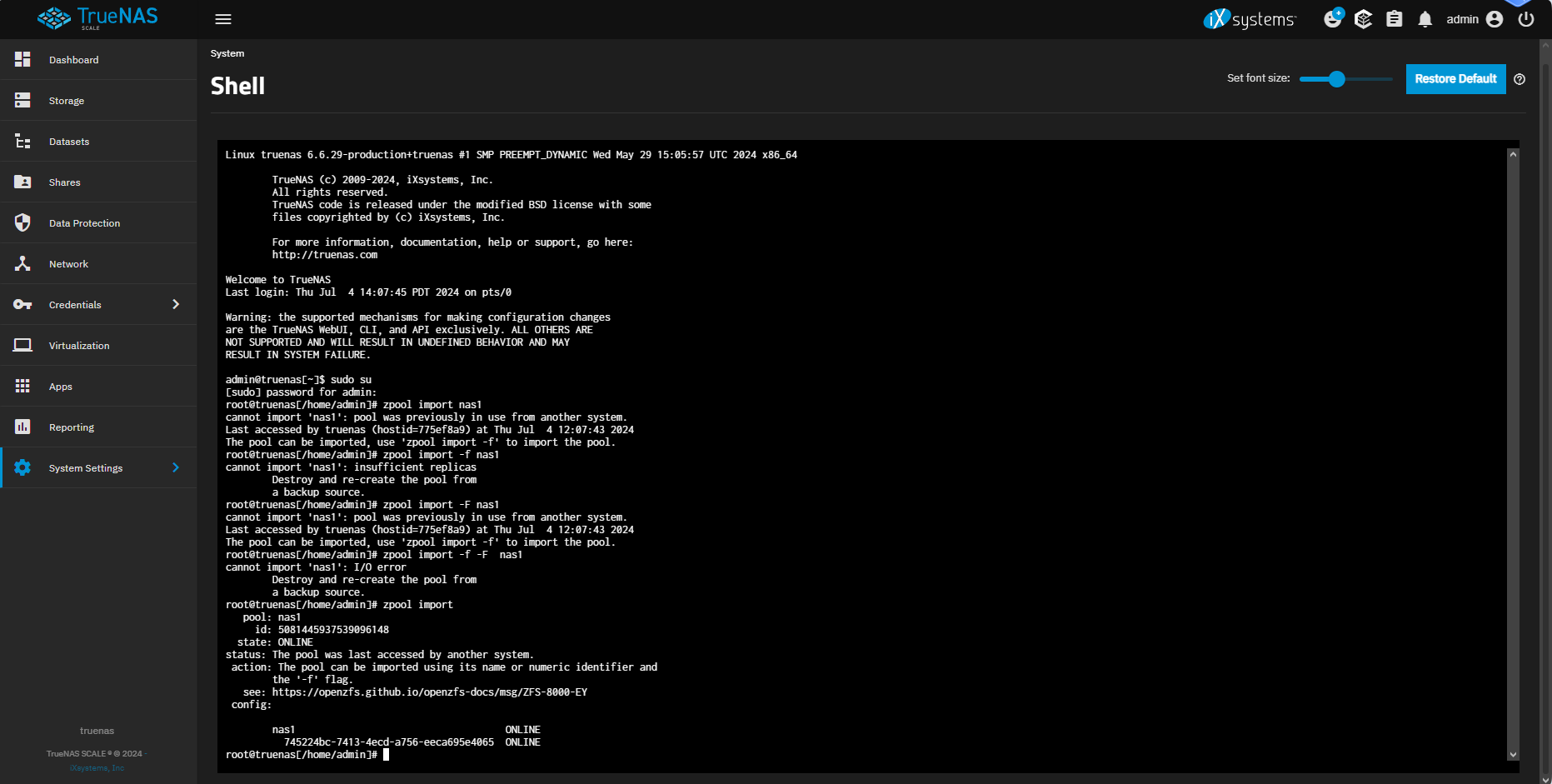

My pool status says “Online” and says it can be imported, but on import it says “2095 is not a valid Error” and when I type “zpool import -f [name]” it says “insufficient replicas Destroy and re-create the pool from a backup source.” and when I type “zpool import -f -F [name]” it says “I/O error Destroy and re-create the pool from a backup source.”

An unexpected power failure caused the array information of the raid card to be lost causing the virtual disk on the truenas to go offline and reimport with problems
lsi 2208
4 disk raid 5
1 virtual disk for truenas

thanks! but i didn’t backup it :( ok but How do I modify this to prevent the same thing from happening? Also I’ve rebuilt the array information and the disks are back to normal, I managed to read out the data just now, but while reading it broke a disk I re-made that disk back to normal, but after that everything went bad.
