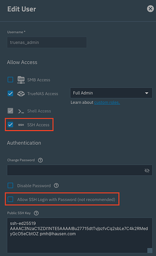

Did you allow SSH access in the user account settings?
I did, thanks. I was overthinking it somewhat (I think) and went back to a guide I’d put together a few years back that I’d completely forgotten about. I need to finish it off with disabling password login and only have key-based login, so that’s my next step. The server is not available outside the lan so there’s no major danger there. I do want to figure out how to access the webgui outsde the lan via a WireGuard config like I have been able with all Scale versions up to Fangtooth 25.04, but maybe I need to post that under a different post?
