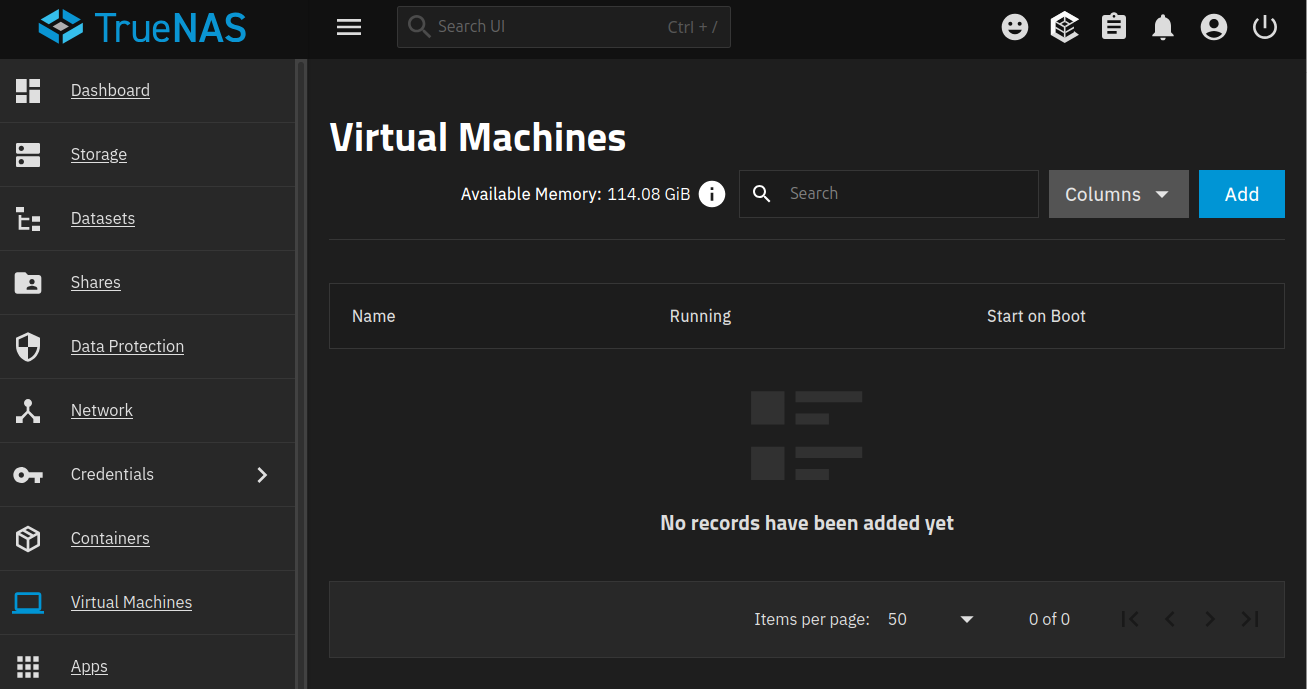

With those two processor extensions/features disabled, under Virtual Machines there are no options anymore. It just says “Virtualization is not supported.”
(Tried before and now to post screenshots and forum refuses, oh well).
That’s odd. I’m on 25.04.2.5, and (with the BIOS features disabled) I don’t see that message on my server. I have no virtual machines setup, but I see “No records have been added yet”.
Clicking “Add” presents me with panel to enter machine settings.
(By the way: I think you have to reach a certain user level on the forums before you can post images)
This is on 25.04.2.6. But no way to add a virtual machine now. :frowning:
