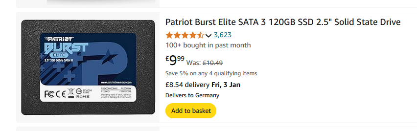

I’ve been using Patriot Burst Elite 120GB from Amazon, which were the cheapest I could find :wink:
No issues to report. They do about 220MB/s iirc.
Available in the UK, too :wink:
And quite a few other in that price range.
Any old SSD will do, it is just for booting up, and have logs written to them, which is why USB sticks might burn out quickliy.
Dam now that’s a good shout. I’ve never heard of that brand but for £9 I’ll give it a shot. Much better than the £30 I was going to spend
