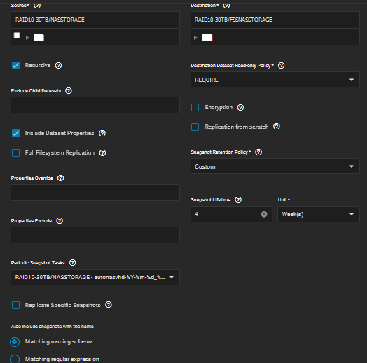

I am a little baffled with the replication of my two truenas server from Source dataset to a Secondary dataset that should be a replication from my Source,
However the Time Stamps are a little different on the sets that i have.
The above is my Source. and below is the Destination for the same value

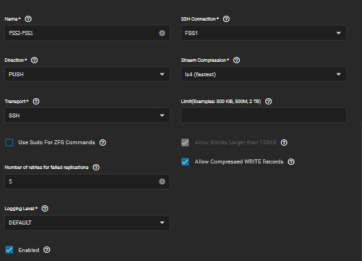

Herewith is my Replication Task.
Am i missing something within my replications, Should i enable the Full dataset replication?
The clock and/or timezone configuration of your two servers is not identical. Type date in a shell on both.
