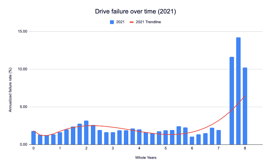

What we IMHO do know, from our own experiences and from the Backblaze data, is that drives mostly fail like this:
Not failing at all for X amount of time.
Then after time Y, all of a sudden, they fail like dominos.
Where Y is, we don’t know.
In the backblaze chart, it is after 8y.
But it isn’t important if Y is after 6y or 10y!
The important thing is, that they behave like dominos.
And in a monoculture RAIDZ, with all the same drives, same model, same runtime, that is IMHO a serious risk.
That is why IMHO something like OPs RAIDZ is risky, despite being RAIDZ3.
If 4 out of 12 drives fail, before he/she can resilver, the pool is gone.
OPs drives are roughly 10y old and have 7y runtime.

Edit: If my search skills are up to snuff, I bought these He10 drives in 2018 or so, used, with like 20k hrs on them. That makes them all 10+ years old. Per your chart, more should have expired by now. :slight_smile:
Naturally, one should not extrapolate from my use case / conditions, backblaze has a lot more drives to draw on. But they also tend to get rid of them well before the curve curves sharply up per @Sara chart.

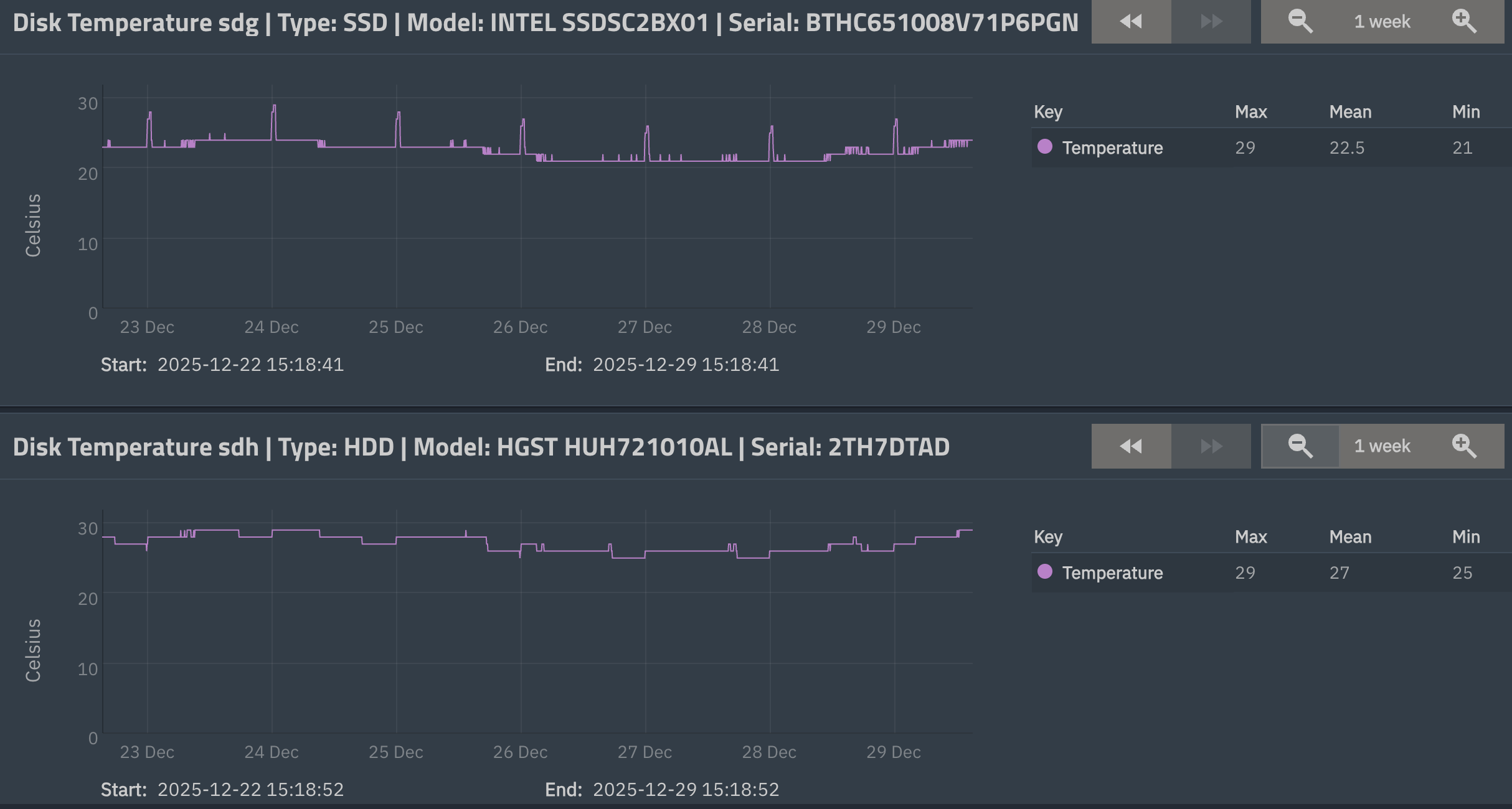

You guys piqued my curiosity… just how cool are those drives running in the stack?
Here are two of them going back a while.

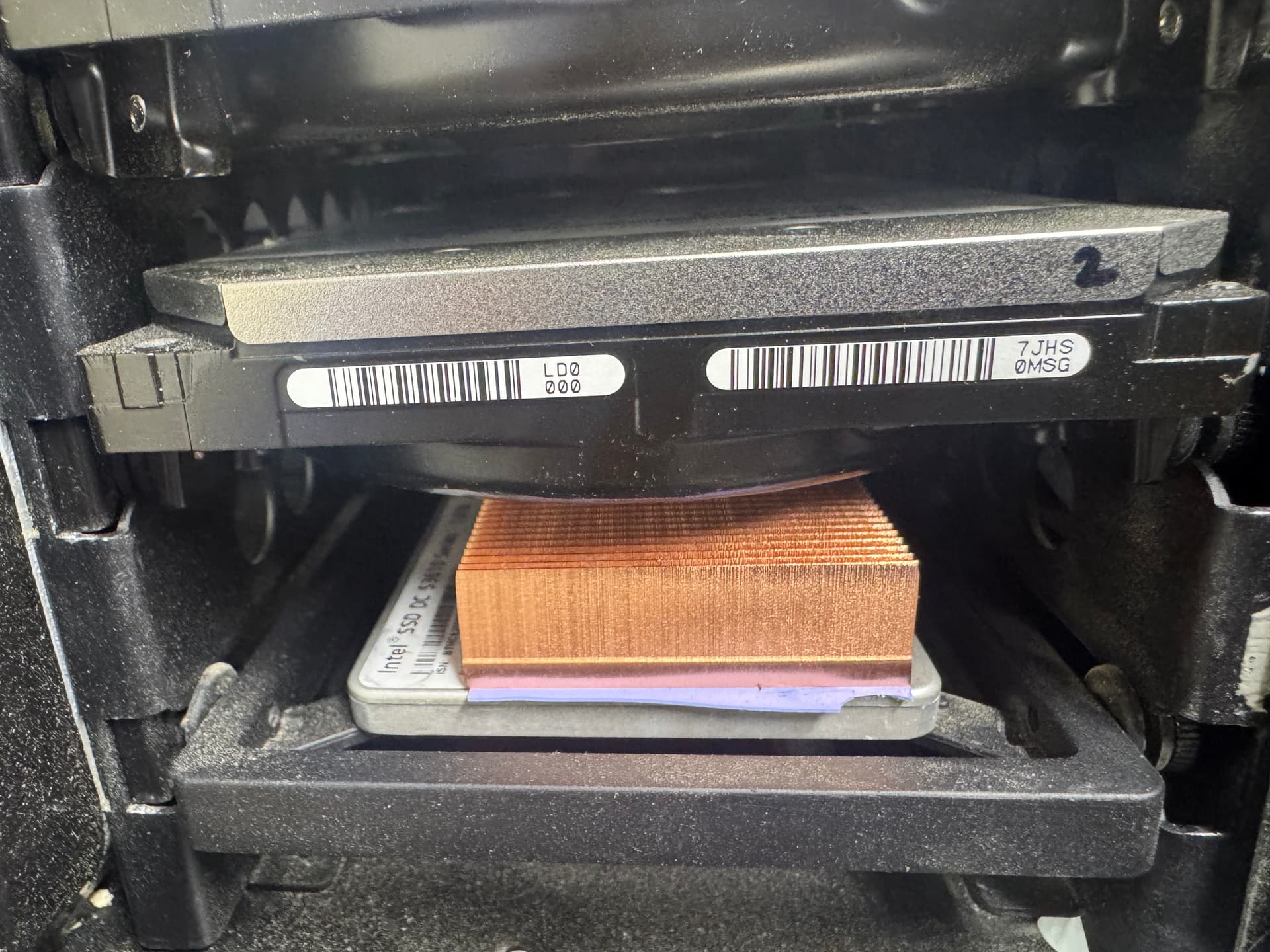

The Intel drive is one of three 2.5" SATA SSDs that make up my sVDEV. The other is one of my 3.5" He10 HDDs. Note how the SSD is running cooler than the HDD, which may be partially due to the heat sink I put on each SSD. Now you may ask, why a heat sink on a SSD? Those things don’t care a lot about heat?
Ah, but this is not about the SSDs… it’s about trying to ensure that every slot in the HDD tower stack gets the same air flow, whether they contain a slim 2.5" SSD or a fat 3.5" HDD. By putting a heat sink on the SSD, I make it taller and increase the static pressure drop in those locations, losing some air flow there while increasing air flow elsewhere.
Depending on the hot-swap design, it’s also the same reason that empty bays in a file server should feature some blocking - to help force air flow over the drives that fill the other ones.
