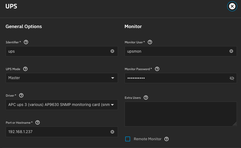

That is dependant on your brand/type. It also took me a couple of attempts to find the right one.
This is my config:
So do not use slave use master.
Nope.
