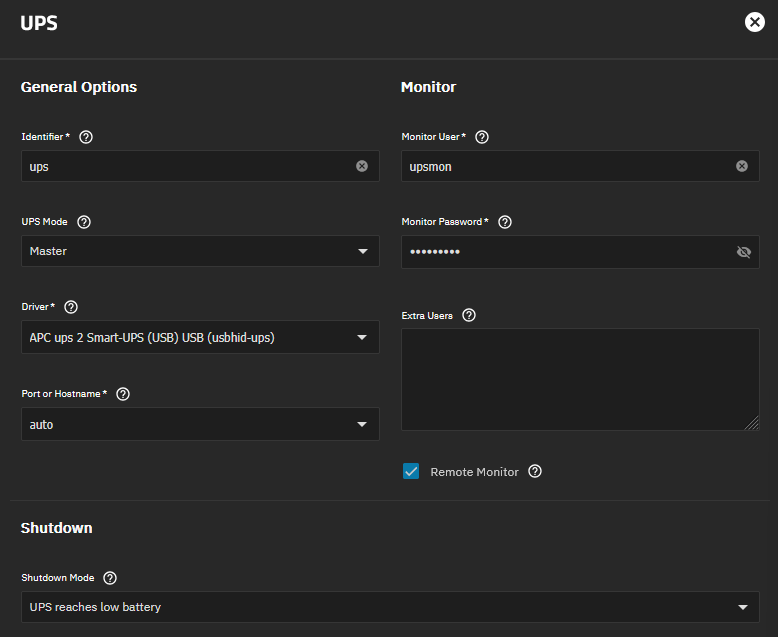

I have an APC SRT3000 directly connected to my server via USB running bare metal Scale 25.10.3.1. The service is running fine with no errors, as a Master device with the identifier of "ups” ( I know this was an issue in another thread).

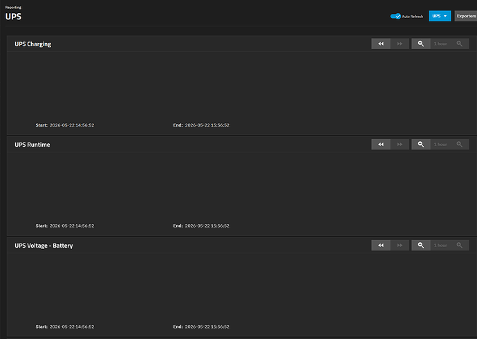

And scale responds to a power outage, however, I get no reporting at all.
Would welcome any help please, is this a long standing bug?

According to the NUT documentation, you’re using the wrong driver, which explains the lack of netdata graphs. You should use the snmp-ups driver instead of the usbhid-ups driver, with configuration parameters set in the ups.conf Auxiliary parameters box.

Your right about that UPS, it normally has the ethernet card, this one just has a USB port which as I said its directly connected via USB, so not sure SNMP driver is going to work.
Additionally other reports in that NUT site suggest its fine with the APC Smart UPS driver.
Also, not sure why would that explain the blank charts - im not having connectivity issues
Is this a known limitation then with truenas scale, that charts only work with snmp drivers?

No, this is basically due to the old version of NUT that’s bundled with Scale. Try a different UPS driver.
That’s not possible - its either usbhid-ups or snmp-ups for APC units. What is it with this driver then that means just the charts fail - sorry, I still don’t understand, communication is fine.
