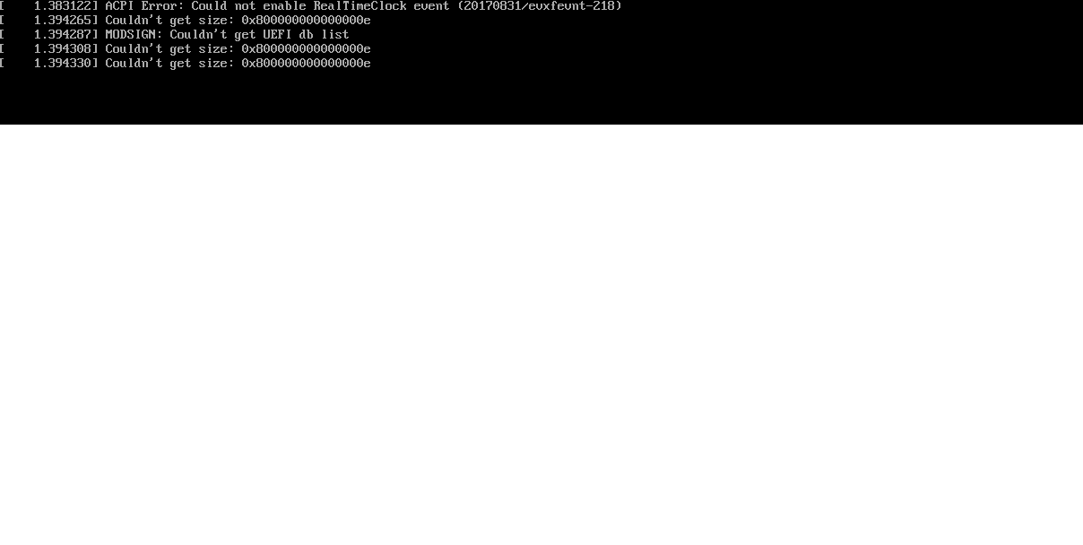

When I try to restart the system manually from the console, it fails and I see this error (below) flash repeatedly on screen. I end up having to power it off fully and power it back on, at which point everything seems to work again.
I’m going to try to remember to explicitly log out from the web interface in the future, rather than just closing the browser. If that stops this from happening, I’ll update the issue.
Here is the error that flashes on the screen. I transcribed it from a screenshot, so any typos are my fault.
