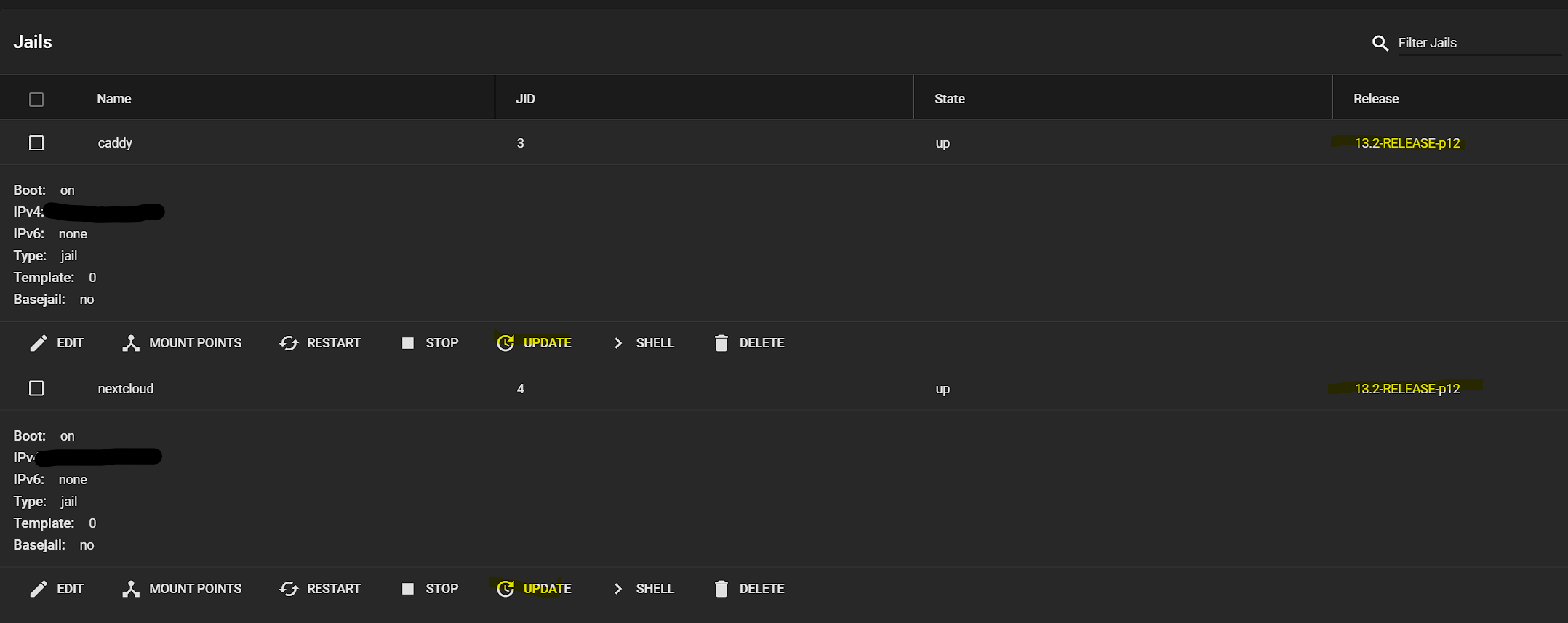

Just ran a fresh install on 13.3, which completed without error and I’m able to log in to the Nextcloud installation. So, a few things to check:

Hi, I’m updating my nextcloud from the web client, things are apparently running smoothly, I just wanted to know if it’s also worth to do a “pkg update” in the true nas core jail’s shell of the nextcloud ? There’s a Freebsd zycore-c package mismatch, am I risking anything if I still do the update ?
btw what’s the difference between a pkg update and pkg upgrade ?
i am now at the Nextcloud Hub 8 (29.0.16) and
TrueNAS core 13.0-U6.1
thanks

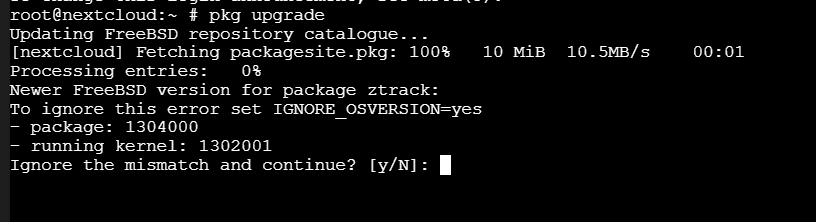

‘pkg update’ only updates the local manifests of current pkgs to compare the installed versions against, it doesn’t do any updates. ‘pkg upgrade’ would download and install pkgs that are newer than the installed ones.
…but unlike with apt, there ordinarily isn’t any reason to do the update first. Just pkg upgrade.
In general, yes, but you’re running an EOL version of FreeBSD in that jail. You could upgrade to CORE 13.3, which would allow you to upgrade the jail to a supported version of FreeBSD (13.4 or 13.5, I don’t remember which). The problem is that CORE 13.3 is also EOL and will receive no further updates. I doubt CORE 13.0 will either, but iX haven’t admitted that yet.
sweet, understood thanks. So in that order i should do :
  1. The truenas OS update to 13.3
  2. Then “pkg upgrade” in the nextcloud jail’s shell
  3. Then update nextcloud from the web interface in the admin page
is that correct ?

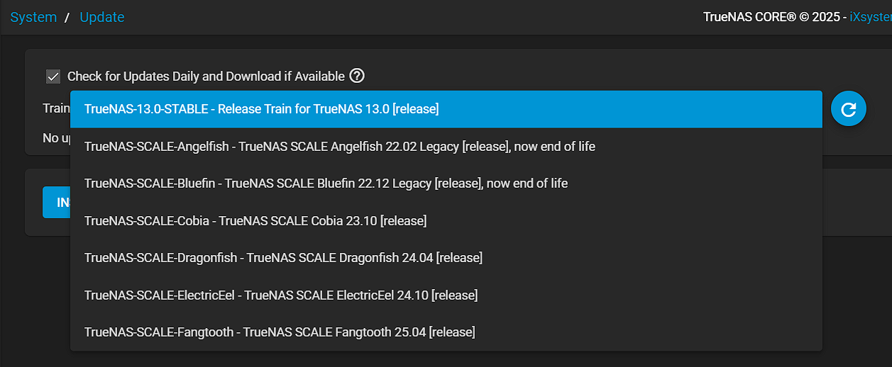

And eventually, i understand that i should switch to truenas scale because of the EOL of core. I’ll have to dig into how that switch works to reinstall the nextcloud and caddy from your awesome scripts :slight_smile:
thanks

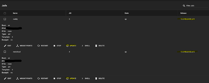

Step 1.5 would be to upgrade the jail to the latest available FreeBSD 13 release.
It wouldn’t be from my scripts; I have nothing for SCALE. It’s probably something I should try to write up, but I don’t think it’s going to be simple.

So I did an update from the jail from the truenas interface :
but then when doing a “pkg upgrade” in the nextcloud jail’s shell, i stumble upon this after updating Truenas core to the latest available today, and update
It now has FreeBSD 13.1-RELEASE-p9 in the shell but still written 13.2-RELEASE-p12 in the release column of the jail… I’m confused

So it looks like it’s not 13.3 but version TrueNAS-13.0-U6.7
When I go in the check updates menu i get most truenas scale but no 13.3 for core.
So my caddy and nextcloud jails are 13.2-RELEASE-p12… I could do the manual download and update through their version of 13.3 on the website but SCALE is recommended, but I don’t want to mess with that yet. Should I still go to the 13.3 ?
does that mean i should or should not ignore the mismatch when doing pkg upgrade or do that when the 13.3 is installed ?
