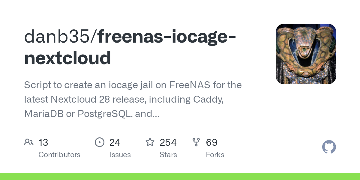

Scripted installation of Nextcloud 30 in iocage jail
It’s been a good run, but CORE has long since ceased to be a viable platform for apps, and with that, I’m pulling the plug on this script and will shortly be archiving it on Github. If you still need a script to install Nextcloud under CORE (or FreeBSD more generally), look at
The script and its docs are still at
