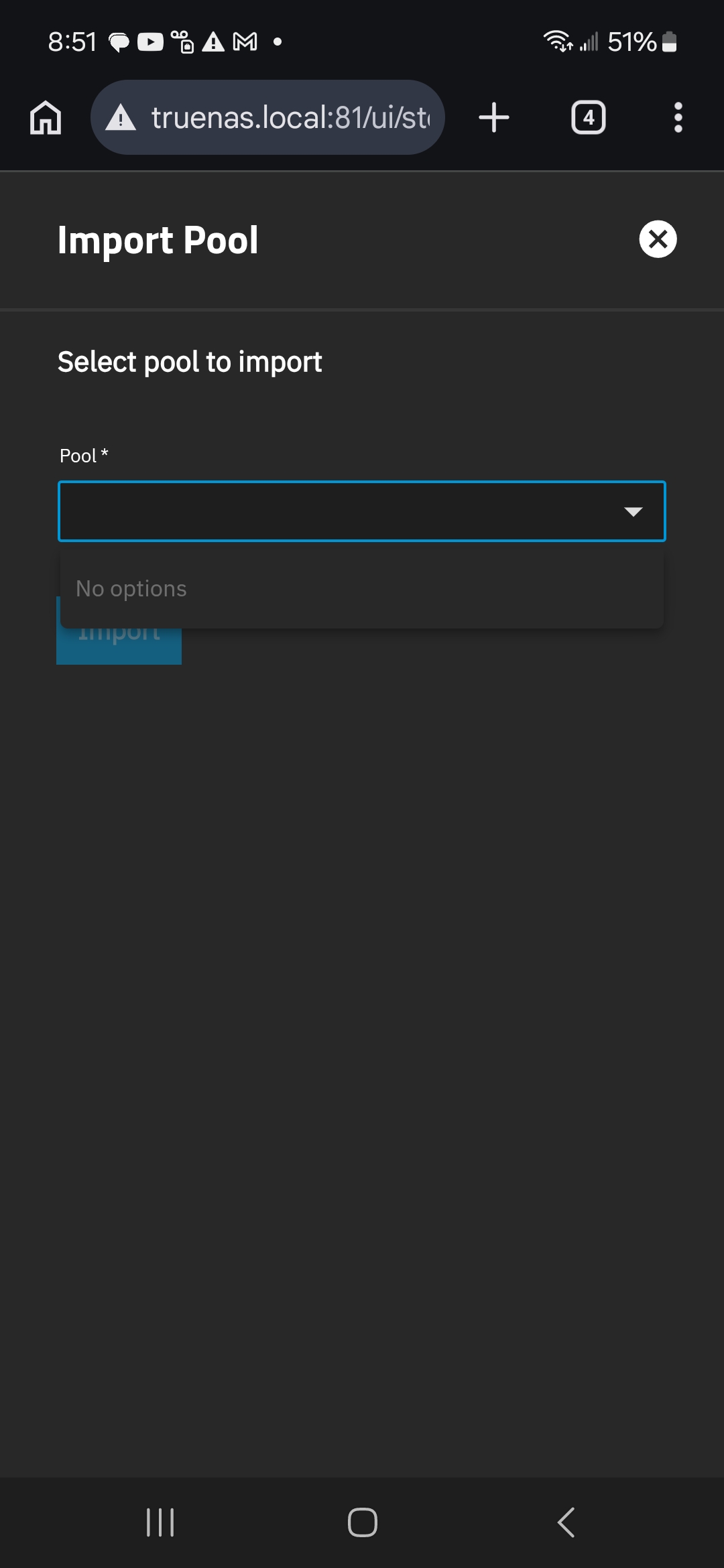

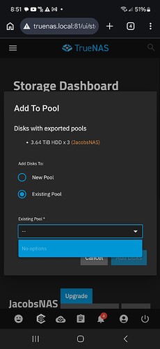

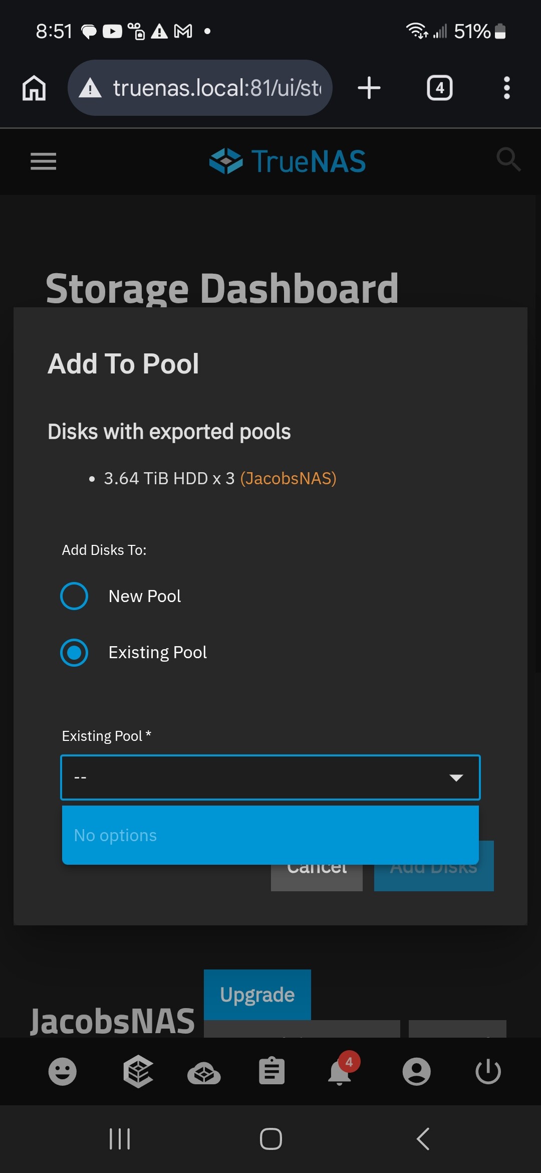

Magically, I was able to install TrueNAS successfully onto this system again. The thing is… one of the first symptoms I noticed when I FIRST posted about having issues was - that when I plugged in an external monitor into the system, it would flash on and off constantly or be completely invisible (dark screen) towards the end of my issues, “the end” being that my server just failed to start. So just immediately prior to my server failing to boot, I had the issue of no video with an external monitor plugged directly into it, although I was still able to log into the GUI through the IP address.. Now I am having the same issue and am still able to log into the server remotely, no local video.
In addition, I am able to see my previous storage pool and it shows the name of the system it is associated with but I am unable to import it.
This is after importing my configuration file.
I have some screenshots to show what I mean:
Note how it shows that it can see “JacobsNAS” as the pool name associated with this set of hard drives. Yet import options are empty.
I do not know if these two factors are related even, but I will try some kind of CPU stress test for now.. my remaining question is this:
Am I going to be f*cked when I do fix the system and try to import the pool? What reasons are there that would allow my previous storage pool to show up as an existing pool but not allow me to import it? Is the pool corrupted or is it possible that errors with the CPU or motherboard could be causing this issue? I set up this NAS for data preservation and I’m going to be super disappointed if I find out that the only way to actually ensure data integrity is to have another $600 worth of hard drives sitting on the sidelines to be a full backup. I’m just a guy, not an enterprise, I store personal data, creative projects and memories, and I thought that RAIDZ1 (or RAIDZ2 ideally, in the future) should be sufficient for me.. until I developed faulty ram (which apparently could have possibly been caused by a faulty CPU or mobo?), and it’s all very disheartening.

Hardware failures like the CPU or RAM could have corrupted the pool and ZFS wouldn’t be able to save you from that. That is why you hear that users should have at least a backup of the data elsewhere. ZFS was keeping your data safer with its checksums and having extra drives for parity in Raid-Z(1,2,3). Some of us have at least two ZFS / TrueNAS systems in different physical locations.
If you get your hardware to 100%, we can still try to get the pool and data back. Your screenshots are just showing the system knows those disks belong with a pool but it is not healthy enough to just import as normal.
If you can post screenshots from a regular computer instead of a phone, it helps. Having a full 1080, or larger screen is helpful for the GUI
Can you borrow a computer that can fit your data disks? We could run the CPU and RAM tests there. Install TrueNAS Scale and attempt to get the pool to import and recover the data.
Another option is if you wanted to try professional data recovery. Klennet Recovery is a product that a few have used to see if the pool could be brought back. It’s about $300 for the personal use license but you can download and run the software to see what it thinks it can recover. You pay for actual recovery.

  3. Again, not sure exactly what you mean, but assuming you mean how the GUI shows it, it’s in this post I made in this thread, there are two screenshots showing what I meant:( Server defaulting to unfamiliar GRUB menu, randomly disconnected storage pool, constant Checksum errors - #28 by OutbakJak )
  4. Cannot import the pool, as shown in that post/comment/images, they show up but not in the drop down for import.
