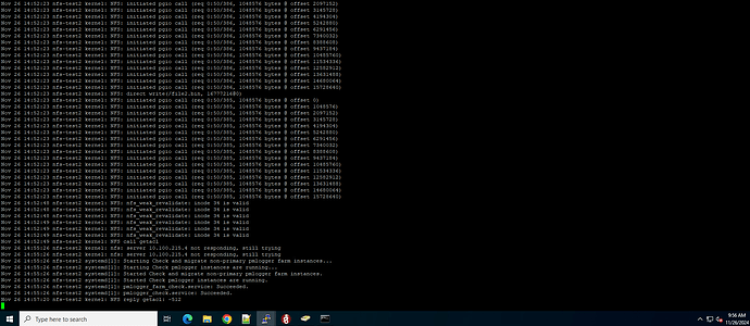

take a look here at a 7 min freeze from writing a file, at that point the os was unresponsive if you tried to watch ls -lh the mounted directory. I originally thought it was hanging on getting the acl, however this seems to indicate something else is going on.
Subnet specific makes me thing there’s some manner of IDS/IPS in the middle trying to inspect the entire file maybe, but perhaps that’s residual trauma from working in the enterprise space for too long. :smiley: NFS will also default to synchronous write behavior but that size of file (1G) should be able to be handled well enough if it’s being written all as a single chunk.
Does the TrueNAS system still respond as expected to local console input or SSH directly to it?
13wZ2 is a bit wider than most recommendations, but with large files you should be able to leverage that width.
