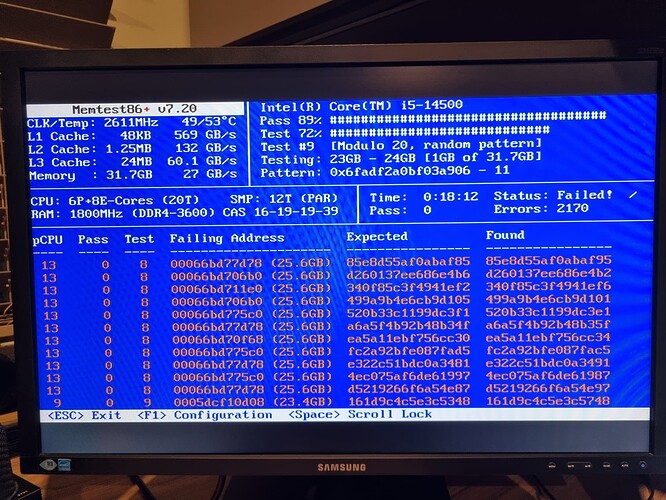

And the memtest86+ have results… and plenty of them
Tried both rams, together 2 times, both time all froze at this point (Pas89% / Test72%)
Then removed one - still got errors, placed the removed one back, and removed another, still errors…
Added same spec rams from my main PC - no errors… (with one first, then added second just to be sure)
So rams got to go, and I guess there is no need to do Prime95 test anymore?

@Gimis Glad you have isolated the problem to a rea hardware issue. Sorry it wasn’t a hard drive, that would have been cheaper. Right now you don’t know if it’s the RAM, CPU, MB, Power Supply.
Something you might try, underclock the RAM to 1600MHz, see how it reacts.
People think that you test your system when you buy it and assume it will never fail those kinds of tests in the future. These few tests are crucial and should be performed probably once a year, more often if you like, definitely if you are having odd problems. They are easy tests to run.
@joeschmuck But why there are still suspects other than RAM?
Got errors in memtest with original RAM, and no errors when switched to RAM from another PC. Or could some kind of issues on other components did some damage to original ram? Faulty PSU or MB over voltage the ram or something?
The RAM interfaces with the MB directly and then all (most) the address lines go to the CPU, and they all have to have power. Any one of these could be at fault, you kind of proved it already when you tested the RAM modules separately and both failed. Is it the RAM, I don’t know.

A test you could perform: Install only one stick of RAM into blue (or lighter colored slot) the second one nearest the CPU (slot DIMM_A2). Now test. If it passes, remove that module and install the second RAM module into the same slot DIMM_A2. If this passes, install the modules so you fill slots DIMM_A2 and DIMM_B2 (the third slot away from the CPU) and test the memory again.
The slots are important, the failing address is important.
Let’s assume the first test fails, then try different combinations of a single stick.
Do they all seem to fail in the same general area? (single stick only)
If the failures are on both stick and in the same memory test location on both sticks, then the odds of it being the RAM are very slim. Use the Failing Address as your reference, it matters if the failure moves around or always fails at a specific address range.

IMPORTANT: If MemTest86+ makes it through one complete test, keep going, let is complete 5 total tests. This is my minimum number required to realistically feel good about the RAM test.
Report back your results.
Be very attentive to what you are doing and the results. Snap a photo like you did above so you have the data for each test case, you may need to look at it again. If you get confused, you can post those images as well.
