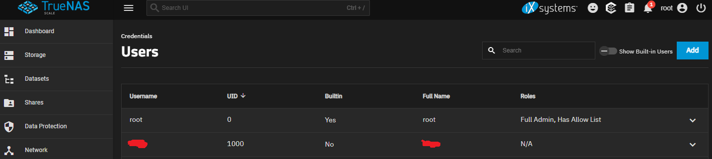

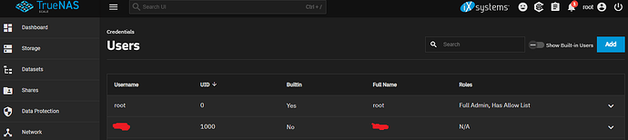

Shows us what user abc’s permissions look like in truenas and on the share itself.
So the user abc is the default for the arr-stack utilities. In this instance it’s been set so that abc = 1000:

On the TrueNAS box, the primary user is an SMB user also set to UID 1000. Windows has an entry in the credentials manager that matches the SMB user name which allows access.
