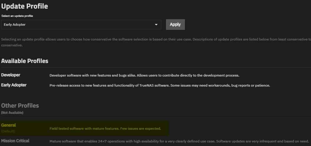

What will be the best practice when this is finally released? Should we revert the
midclt call smb.update ‘{“smb_options”: “smb3 directory leases = Yes”}’
workaround we’ve been using to mitigate the issue? If so, before or after the upgrade?
It’s probably a good idea to switch back to defaults. If you do this, then your configuration will be automatically updated as we grow confidence in new feature / performance characteristics.
I understand your perspective. From my viewpoint, once the option becomes available, I’m going to switch my profile to “General (default)” on my “production” machine, and them probably set up a mimi PC for testing purposes. I just have to ensure that the miniPC has two NVMe slots.
Because you like bugs.
What an odd thing to say.
I understood @MarkHoltz’s plan to set it to General instead of Early Adopter specifically in order to avoid the most untested (and thus buggy) releases.
