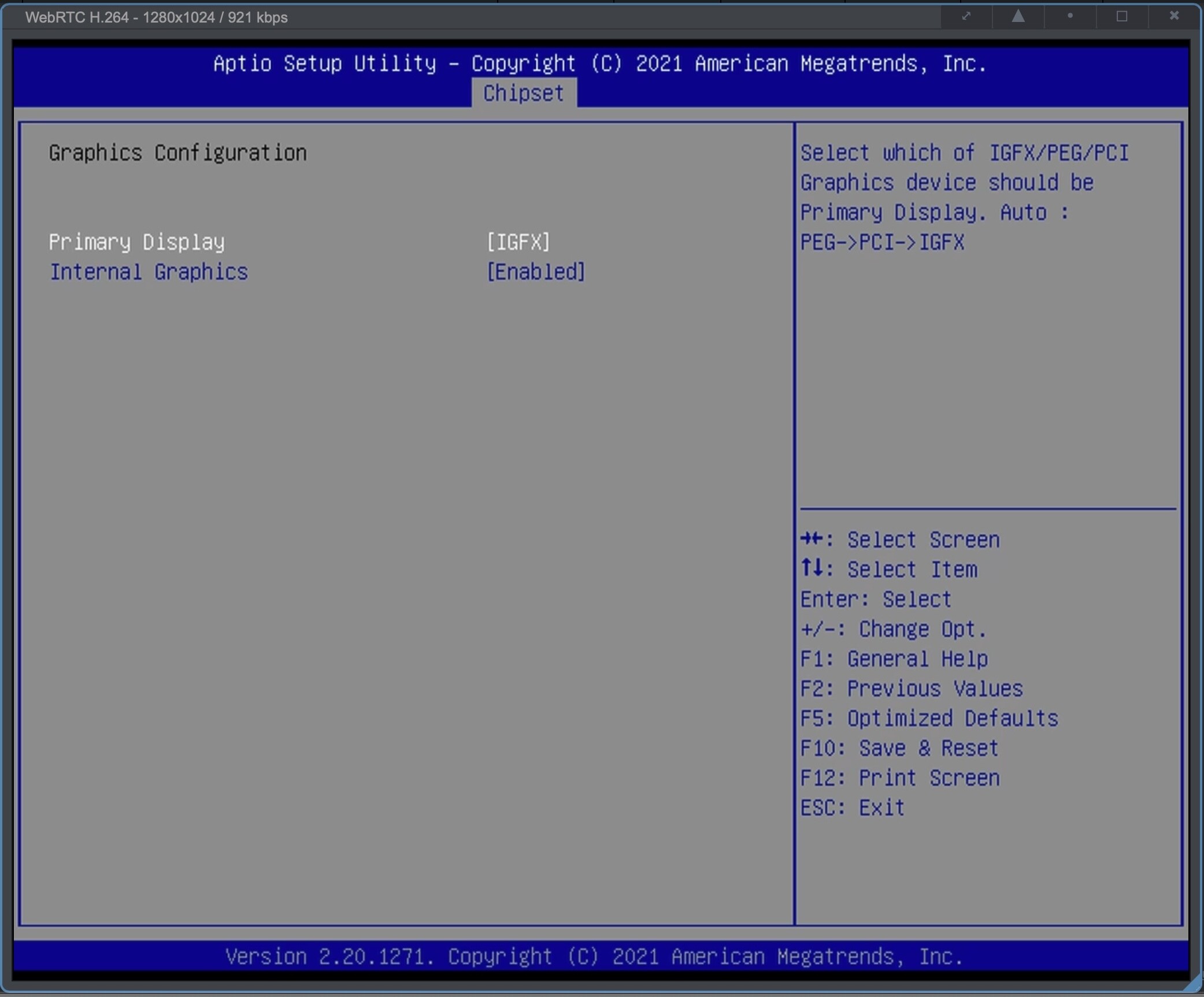

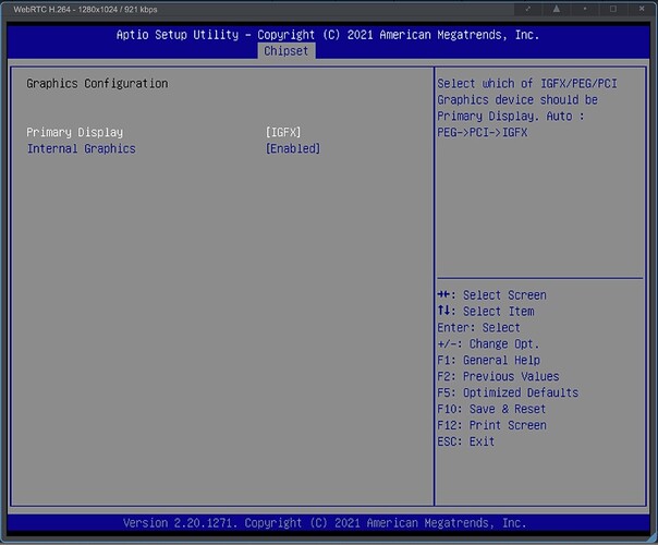

I’ve been able to check my machine now. I had to change a setting in the BIOS under “Chipset” > Graphics to “IGFX” instead of “Auto”:
I guess in your case it would depend on how the IPMI receives its display signal but I’d advice chosing explicitly in the BIOS the equivalent of Primary display and ensure it’s not chosing the GPU.

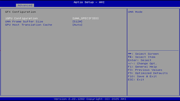

Just looked again.
The only thing related that I can do is about the iGPU:
I cannot select a primary device there nor anywhere else. I just looked through all BIOS menus again.
