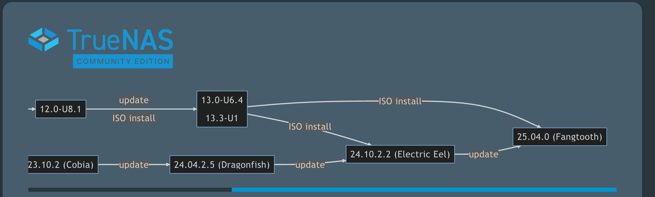

Sorry, but its important to follow the update instructions in the release notes.
The only path that gets tested and validated is that. 25.04 (Fangtooth) Version Notes | TrueNAS Documentation Hub
In each version, we may have some migration steps which clean up issues between versions. For example, 24.04 - 24.10 includes App migration from K8s to Docker.
This is the key diagram:
For rollback to 23.10 it should work, but it depends on whether you updated the pool. What did you in 25.04.0??

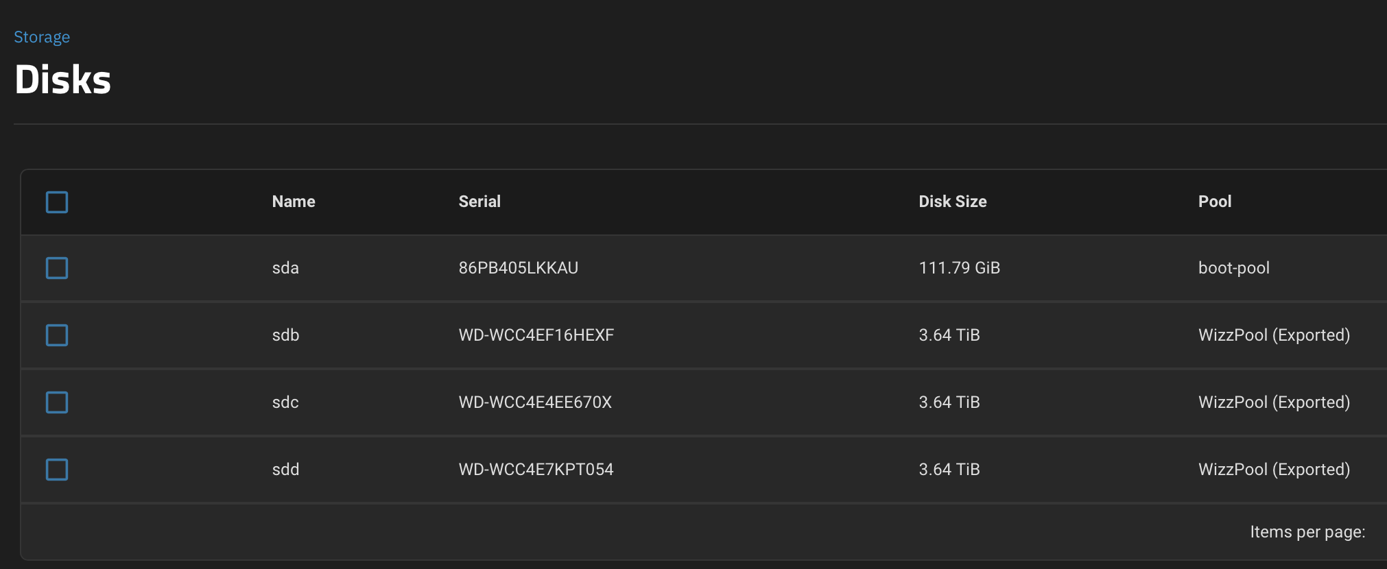

I booted into 23.10.2 and the pool shows there but inactive and it does not show up under import just like in 25.04.
Under Disks, it shows the pool as “Exported”, I just can’t do anything with it.

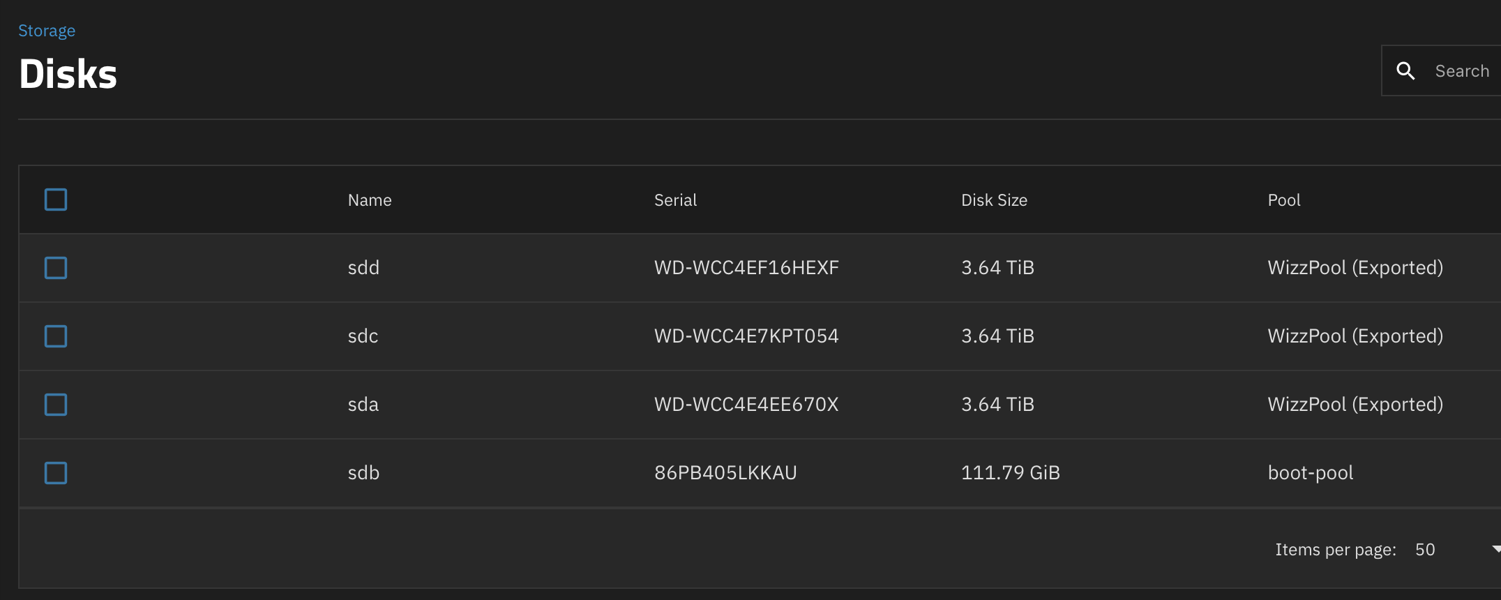

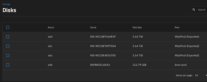

Yes, I just rebooted into 25.04.0.
Also, once I did that I noticed that sdb is now my boot disk and not 1 of the 3 WD drives. It’s like it renamed them in 25.04.0. I’m wondering if the SMART error is because it’s an SSD?
Thanks!
Don’t know where or why that would happen?
Its a good lesson in making sure that each step works… we could see where the problem was created.
So, you’ll have to fix the boot pool 1st…

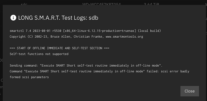

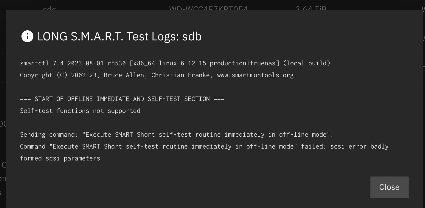

I’m not sure what to do with it at this point. When I try to run a manual test on it, it says “Self-test function not supported”… Here is the message I get…
No, stupid me it never even crossed my mind… :anguished:
This is the Toshiba SSD… it may not support SMART??
Yes, and I think that is what is driving that critical error I posted originally since it is saying almost the exact same thing.
So, I’m guessing there is nothing wrong with the boot drive/pool… Would that be your assessment also?
