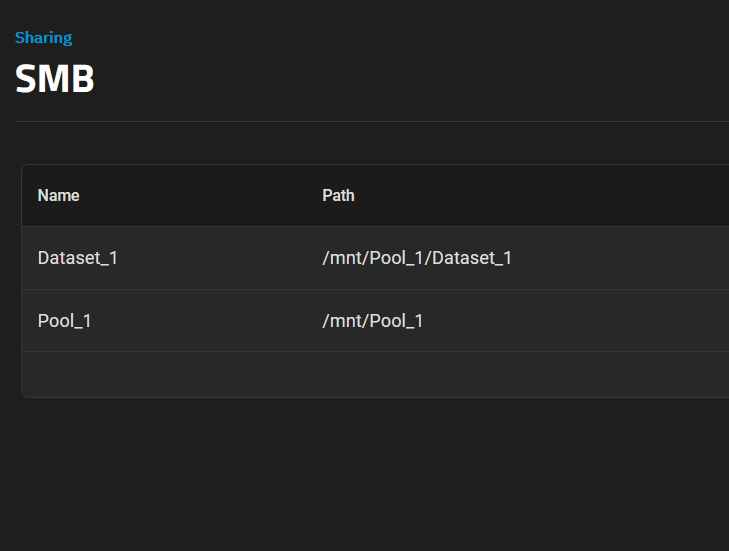

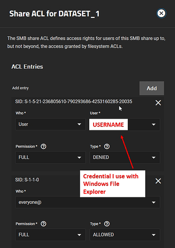

Maybe a couple pictures will help.
Error message is “you require permission from Unix user\apps to make changes to that file.” Even though I am the owner of the dataset?

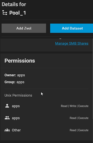

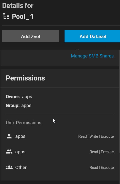

One more tidbit, Pool_ 1 shows this as ownershipMaybe the issue is there Not sure how to add User ==> myusername here. I go into “Manage SMB shares” and add me but it still doesn’t show up here. “Apps” is the owner and won’t let go. Last question, do both my pool and dataset need to be configured SMB? Or can I just do it at the pool level?

Problem is now solved, somewhat. I restored the TrueNAS configuration that contained Plex and uninstalled the Plex app. Permissions are now all restored and I can map to them in Windows File Explorer. I’ll have to go back and figure out how to install Plex without making the mess I did last time.
