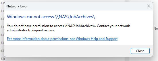

From one of my windows clients I get this , a notification that there was a problem accessing the share then, it switches to this dialog.

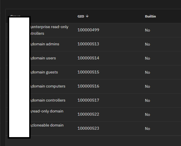

Checking in via the Trunas GUI, it appears it is failing to resolve the group IDs to the group names… the group ID’s on disk have not changed though.

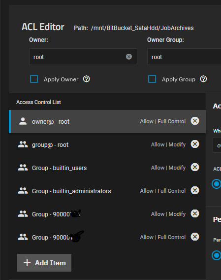

Also I have 2 ACL presets that use some of the same groups, and the JobArchives share that that is currently inaccessible when I try to reapply it from the preset (without stripping it) it does not resolve the group name correctly as in the screenshot above , but the other presets are still correct (eg the one for my main share which ) so something funny is definitely going on within Truenas itself.

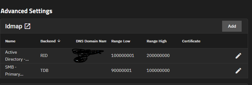

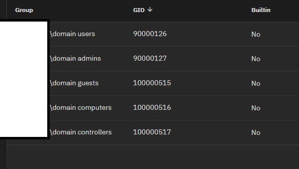

Should these GIDs not match the IDs in the filesystem for this share? They are 10xxxxxxx instead of 9xxxxxx ranged ids.
it looks like the AD and SMB IDs are getting munged up?
You can see here after rebuilding the AD cache… it has changed the GIDs for some of the groups in use.
