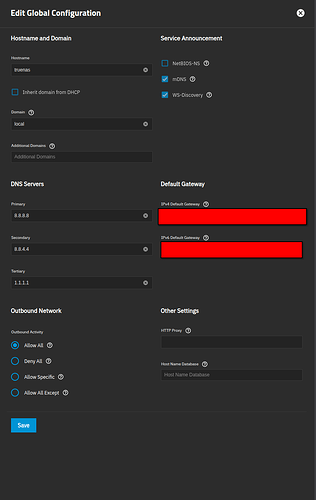

My networking hardware setup is very basic, TP Link CR700 modem/router. No firewall on the router currently. Here’s my network config on TrueNAS. I have DHCP on and my network interface is enp0s31f6 for whatever that’s worth

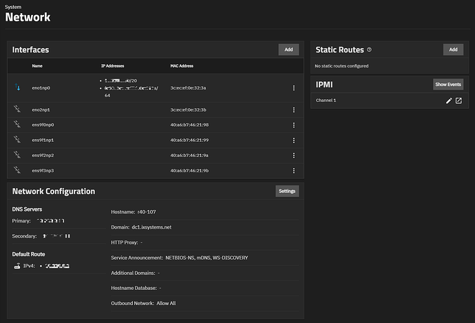

Please also post a screenshot of your interface config. Do you have a bridge with no IP, but the IP on enp0s31f6?
Here’s the interface config, I think. I don’t even know how to answer that question haha I apologize I’m fairly unfamiliar with networking stuff. I don’t think I have a bridge?
Updating and still looking for help here. I fully re-installed the OS and still facing the same issue.
Not the edit screen, the summary screen.
Oops my bad, sorry
What happens if you replace the hard-coded Google/CloudFlare DNS servers with the DNS servers from your router? This smells like something local to your network.
