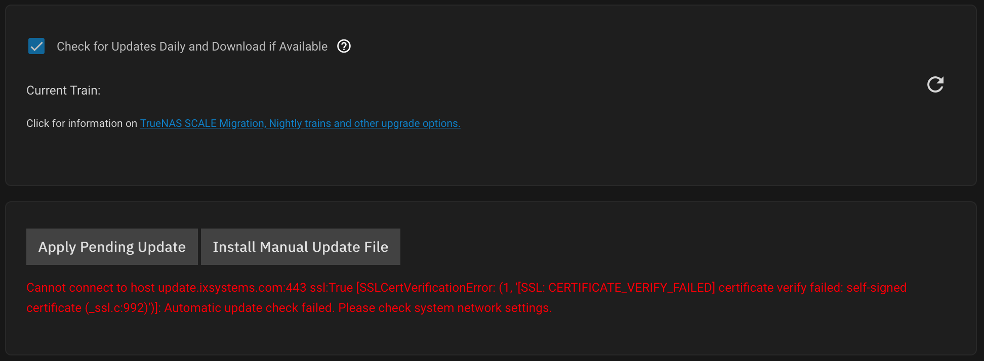

My NAS cannot presently contact the update server due to a SSL certificate issue. Are other folk dealing with the same problem? Who do we contact re: such issues at iXsystems? @kris?

Thank you for that… it’s curious - the pi-holes started blocking http://update.ixsystems.com/ for some reason. Once I white-listed the domain, Iit resolved OK. The certificate error was bizarre.
Same issue here. TrueNAS scale virtualized on Proxmox. Research indicates it may be a time sync error to GMT/UMT, but my Tyan board syncs to time.nist.gov, and all my systems report NTD sync. So that can’t be the issue.
No, that would cause a different error, which would be something about the cert being expired or not yet valid. In your case, like in Constantin’s the error says that you have an invalid cert. The most likely reason is something similar to his: you’re using DNS-based ad blocking and have for whatever reason blocked the iX update servers.

That was it. After whitelisting update.ixsystems.com absented that error.
