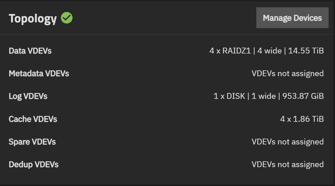

So you have 16 HDDs in a stripe? Just to ensure, can you post the output of sudo zpool list -v <your-pool-name>?
I am using crystal disk for convenience of testing.
What was the number of tests? Did Q8 and Q1 have significantly different values?
