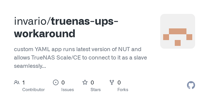

I’ve come up with a workaround for users that have a UPS affected by the old version of NUT that is used by TrueNAS which throws false alerts of a battery failure (“replace battery”). My workaround doesn’t require anything except to run a custom Docker app via YAML and to set the TrueNAS UPS service to “slave” mode to connect to the new (and updated) NUT “master” running in the container..
Best thing about this is:
  • doesn’t require disabling safety checks
  • persists across updates
  • easily reversible
The code along with instructions are at my repo here:
I hope someone finds this useful!

Hi, to answer your questions:
The driver name is actually there in your screenshot. (usbhid-ups). A lot of devices are supported through that driver, even ones not from APC.
The image can be updated if you modify the YAML’s ARG nut_version variable, which is currently set to v2.8.5. It needs to match a release from the actual NUT repo.
Yes, once you put it the TrueNAS UPS service into slave mode, parts of the dialog disappear so you shouldn’t even be able to change the UPS model setting anymore.
Alpine:3.23 with a bunch of packages installed by hand and NUT cloned via git and built from scratch.

UPDATE:
I am removing the docker-compose.yml that I made and am replacing it with a bash script that will:
-build the latest NUT drivers
-copy the new usbhid-ups driver into a specified directory
-automatically update the ups.conf to allow loading of the alternate driver
Changes are easily and completely reversible, and only one file (usbhid-ups) needs to be retained from the build. In fact, a restart reverts all the changes and that’s why a POSTINIT command (taken care of by the script) is necessary.
This retains full functionality, including power down.
