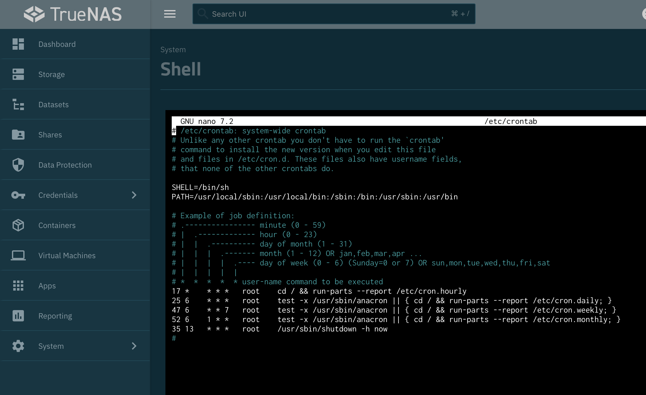

I tried (and failed) to get my TrueNAS box to shutdown on a schedule using the GUI cron job interface. For some reason, I just couldn’t get it to work. It would proclaim it had completed successfully in the logs, but that was not true at all!
I solved the problem by manually adding a shutdown command to the crontab file using the system shell.
sudo nano /etc/crontab
Then add the following the the bottom of the file:
00 01   * * *   root    /usr/sbin/shutdown -h now

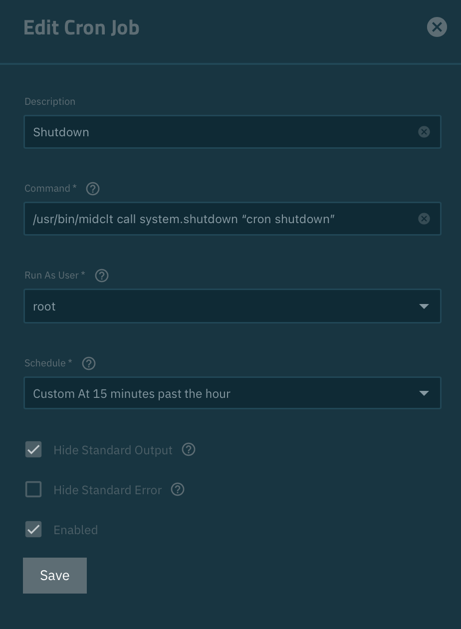

Please post a screenshot of exactly how you have midclt call system.shutdown configured in the cron section.
Thanks! I’ve set it up and report back, whether it’ll work tomorrow! Thanks so much!
That’s probably going to work, but it won’t be persistent. I was asking for a screenshot of how you actually set it up because your post didn’t go into any detail making it difficult to pinpoint the cause.

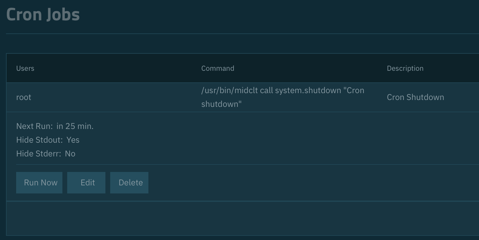

A cron job defined in the GUI like this ought to do the job:
/usr/bin/midclt call system.shutdown "Cron shutdown"
A difference from running the command in an active shell is that your shell has the path setup, so you don’t need the absolute path when you do it manually. I also added a shutdown reason in quotation marks because I think the command still requires that.

It persists between reboots, but it probably won’t persist between os updates. If there’s a solution that uses the GUI cron job that would be much better. Have you tried that?

…this doesn’t work:

@neofusion my GUI-Setup for the cron job was exactly as substeeze has screenshotted above.

I’m also on 25.10.1 and just tried the GUI Cron again with your change of quotes, but still doesn’t work.
If I click the ‘run it now’ play arrow, yes, it will shutdown. But it will not shutdown on the schedule I set. Very strange.

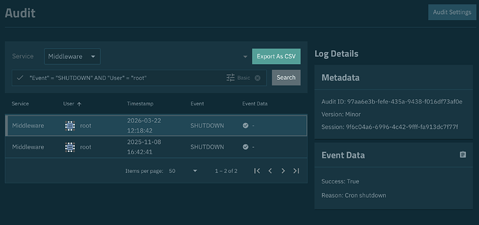

Have you checked in the Audit Logs to see if there are any clues?

Ok. Just run the GUI cron again (scheduled for 12:55). In the Audit log, there is something that claims to have run, but it hasn’t shutdown…
and in the syslog I have this:
Mar 22 12:55:01 TrueNASBackup CRON[3859]: (root) CMD (PATH="/bin:/sbin:/usr/bin:/usr/sbin:/usr/local/bin:/usr/local/sbin:/root/bin" midclt call cronjob.run 6 true > /dev/null 2> /dev/null)
Mar 22 12:55:33 TrueNASBackup systemd[1]: Cannot find unit for notify message of PID 3864, ignoring.
I show two entries. One in Middleware and two? in System around the shutdown time. I was logged out of TrueNAS when mine did the Cron shutdown at 19:38 time
Yes, I get that too - but it doesn’t actually shutdown the machine…
going to give it another shot in 25mins…
Ok, so I set it for 16:23. All I see in the logs is a System entry for CRON. I am assuming this means the cron daemon has triggered on the schedule ok. But there’s nothing in the Middleware logs, so it seems the command has failed. This could be a permissions issue with user ‘root’ perhaps? I’m going to try poking around with the user credentials and see if I can solve this.
