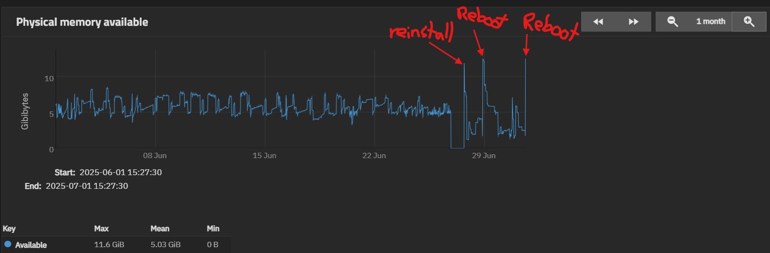

I just went to look at reports to see if that gave any insight and noticed that for the past month my free memory had been hovering around 5gb (see screenshot below)… You can then see between June 22 and June 29 my system was offline for a bit which is when it wouldn’t boot after getting the above error. Since then it seems like my system memory free continues to decline until there is only about 1gb left. I’m wondering if this is when the web GUI becomes unavailable. You can see at the very end of the screenshot my free memory was really low, then after a reboot it was back up to the top.
Check for App updates. There may be an update to fix a memory issue. You can also check you App configuration for RAM settings under each app. Keep an eye on the Memory and try to see if you can associate it to any activity. It might be backups, Immich scanning or doing image things? If you get SSH set up or just try logging in at the console when you have problems, you can try looking at TOP and HTOP to see what is going on.
16GB isn’t much if those apps are needy
Thanks for the info, I’m also new to Linux so I didn’t know about TOP and HTOP, those look really helpful. So far I haven’t lost access to the GUI the rest of the day today after the reboot and the free memory has stayed relatively high. I’ll definitely try to check TOP and/or HTOP (directly from the machine via monitor/keyboard) if this happens again.

Also, I haven’t experienced the web GUI becoming inaccessible again since my reboot yesterday (24+ hours) so that’s good. I also realized my memory isn’t really getting all used up… I did more reading and learned about ZFS Cache intentionally using almost all unused memory until it’s needed. So I don’t think free memory was my issue.
Yeah free ram is considered wasteful in the Unix world, because it could be doing something. So that’s intentional, I would be more concerned if my server wasn’t eating all the ram.
