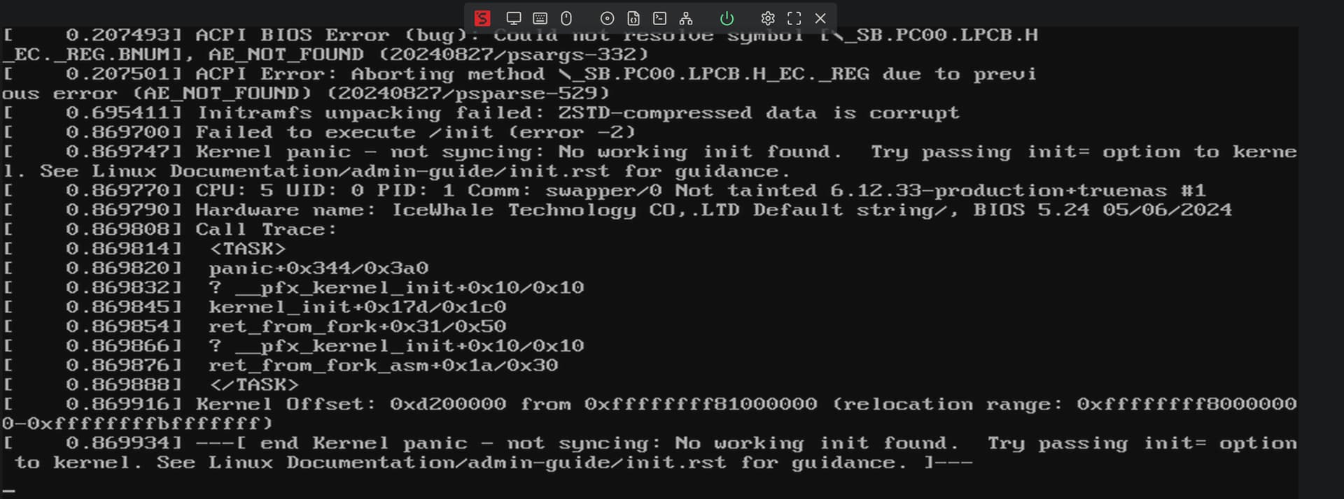

Can't fresh install anything higher that 24.2.10.4 on ZimaCube Pro
I am installing truenas on my ZimaCube Pro, havent done this in a while, its my test machine, but it used to work. I had no issues installed hexos earlier today. Thought this was interesting when i went straight ot a 25.10 nightly
then i tried 25.10-beta 1, same issue
then i tried 25.04.2.3, same issue
then i tried 24.2.10.4 and while i see the first two ACPI errors the initramfs unpacks just fine and install completes

i tried disabling vt-d like the folks in the terramaster thread are doing, no difference.

edit: i did a build to build upgrade within truenas just fine, this issue seems to be an installer issue maybe related to the KVM or underlying hardware. i will try and replicate with an actual USB key when i have time, the ACPI error seems to be noise rather than an actual issue
any ideas on the root cause?
