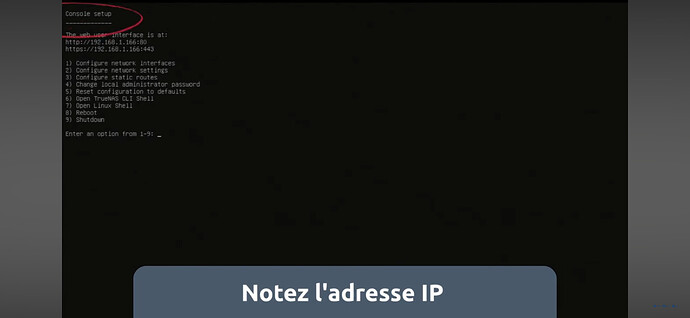

You need to put a monitor - keyboard while boot TN on the new mainboard, and select the option to reset the network configuration

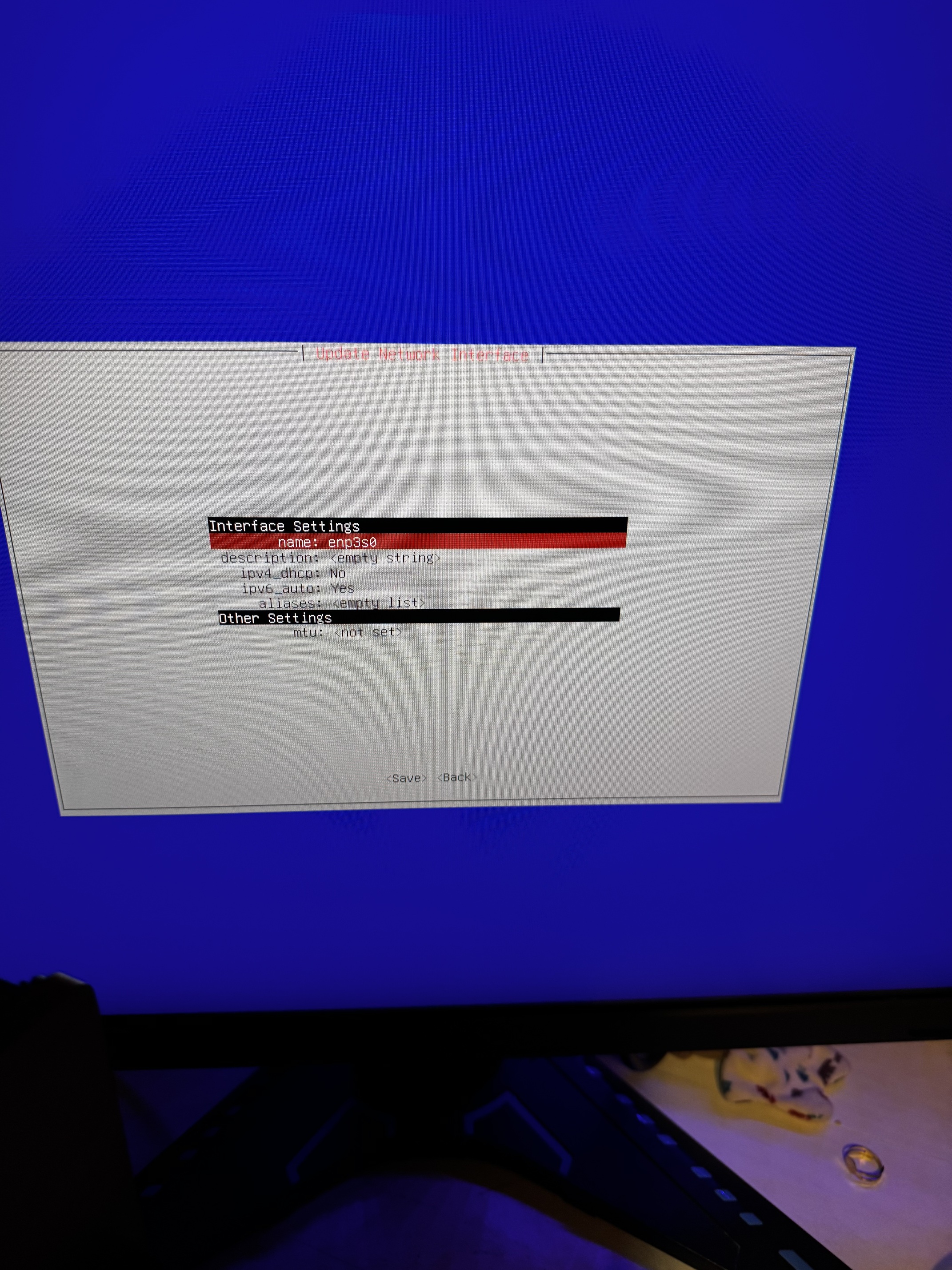

Thanks for your reply. Here what I have
@Jorsher, yes. It’s the motherboard of my PC on Fedora and I have no problem with the ethernet connection. Idk why I have that :confused:
I don’t know. Do you have a reservation for that IP with the previous MAC?
Have you tried DHCP?
I don’t use DHCP. I don’t have a reservation for that IP :/.

Did you reset your TrueNAS network configuration as suggested earlier?
No not yet. I dont have reset network option but reset configuration. It will reset everything ?
It’s not from me but i have that too with option 5.
Probably was something that was in Core and not more in Scale, the options/menu in your screenshots look kinda different from what I remember.

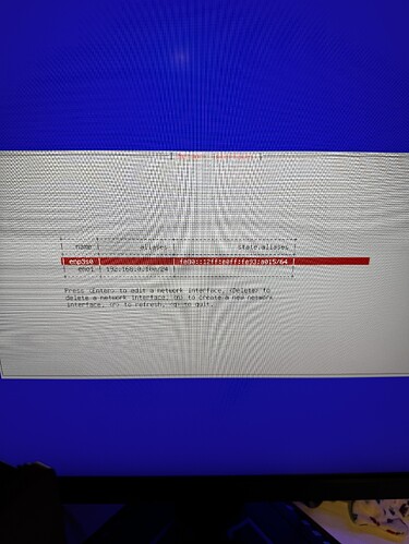

If you already checked that this specific IP Is not reserved, i would suggest you to try to use the DHCP > log into the GUI > restore the ip you want

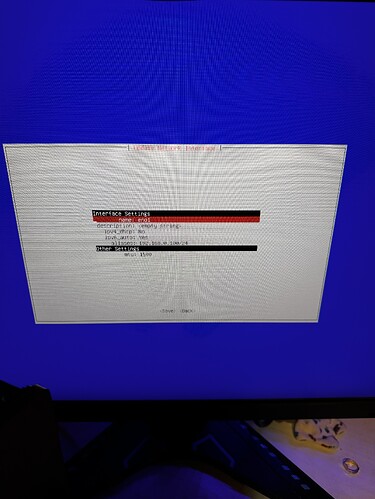

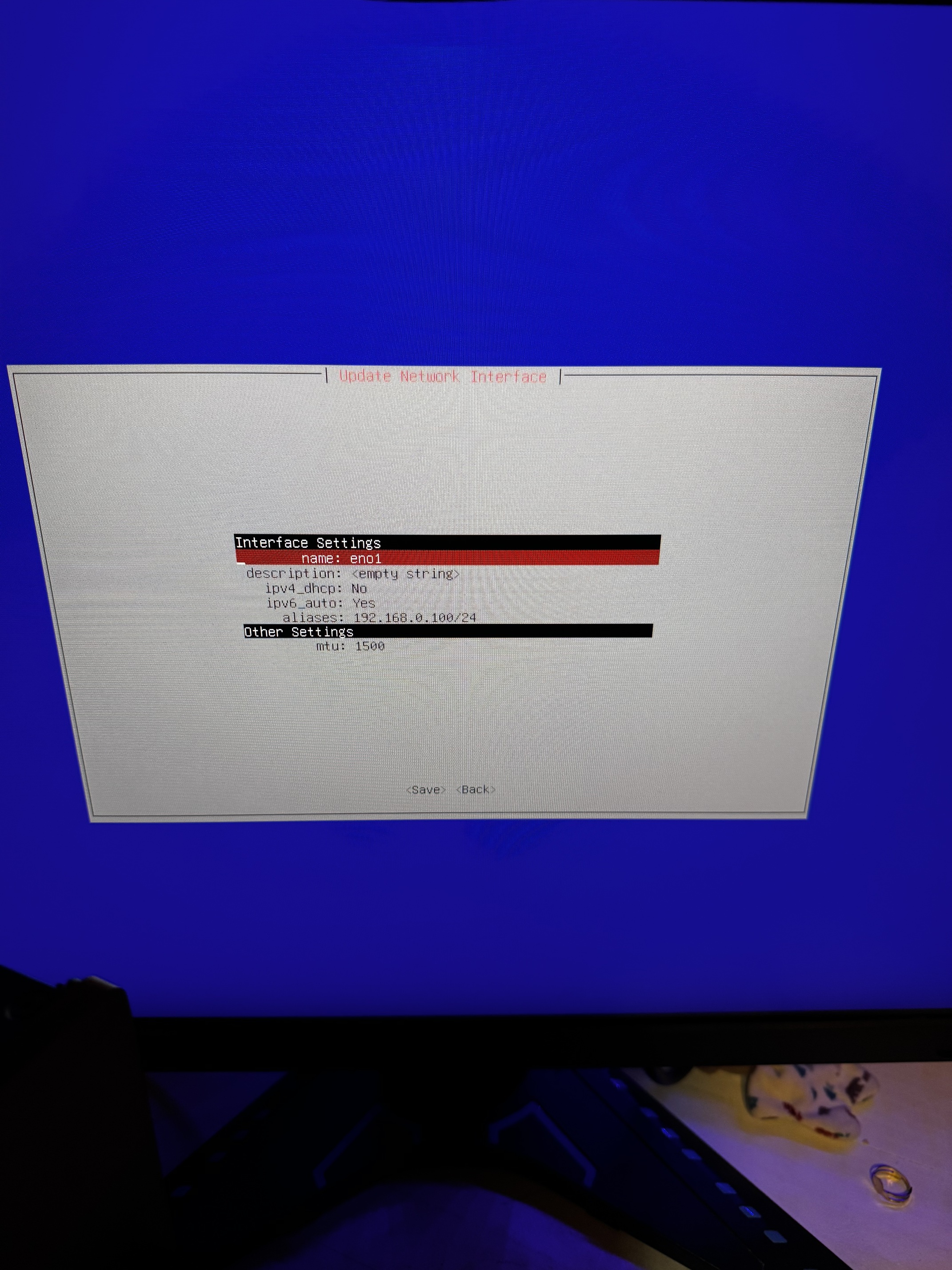

Guessing here, but could it be that enp3s0 is your new NIC, which isn’t currently set up, and eno1 is the old one that was set to a static IP?
If so, remove eno1 and set enp3s0 to DHCP to see if it grabs a valid IP for your network and login. Then swap to your static IP of choice in the GUI.
I’m a touch confused on why you have two interfaces showing as the motherboard only has one physical ethernet port (…unless the board has wifi & that is causing issues?..)

Another question - what happens when you try to connect to the ipv6 address randomly assigned to enp3s0?
http://[fe80::12ff:e0ff:fe93:a015]/
In short, I’m suspecting neofusion’s suspicion is correct.
It’s option 1
will take you through it
What has happened is that the old motherboard has one type of network card and the new has a different type
Truenas has a configuration for the old nic but not the new - so you have to set it up
