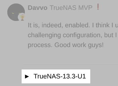

There is still one task remaining.
You traitor. :disappointed_relieved:
Don’t worry, that system is still faithfully serving (actually doing the heavy lifting)!
1k characters in the signature is limiting, had to cut a bit to make space for both systems.
