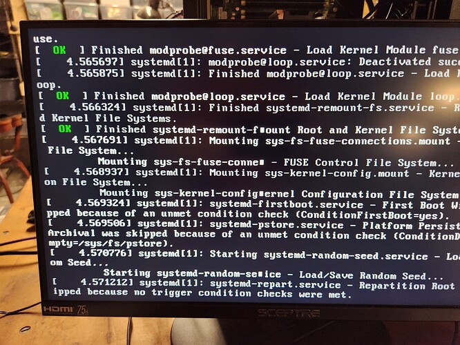

I am back. Today was a bit of a write off from a work point of view. My work laptop wouldn’t boot (crowdstrike!) so I had some time to install TrueNAS scale on a fresh pair of SSDs and my Dev system hardware.
On reboot after setting the admin password, removing the install USB, etc … I do not get the console menu. I get a lot of TrueNAS boot things with green OKs down the left.
Did I miss something? That said, does my system have the required hardware?

I just booted up a VirtualBox TrueNAS Scale VM to see the boot. The console eventually shows. How long are you giving it to boot and where is it getting stuck? Any error messages?
Which version? 24.04.2?
In a VM or bare metal?

Re boot … seemed like ages (10 mins) and then it got stuck. I will reboot and leave it overnight :).

I think ten minutes was plenty. Try to pay attention to the ones that aren’t OK (green)
We have to figure out where it is getting stuck. Can you scroll up and check?
I don’t remember the screen responding to my mouse. I will swap it out and see. Any way of porting the boot info to a log file?

Decided to try reinstalling … here are the steps I took
  1. reboot with USB install stick plugged in
  2. F11 to get boot menu
  3. boot from USB stick
  4. select TrueNAS Scale Installation (there was another option that looked the same just had 115200 baud at the end
  5. selected install / upgrade
  6. selected both SSDs (mirror boot pool)
  7. accepted warning about data and partition erasure
  8. admin user option
  9. short password (that I will change later)
  10. yes to create 16Gb swap partition
  11. install stared … extracting, extracting, …
  12. install on SDA SDB succeeded / reboot with no USB stick
Here is the screen I have at the end of that
screen after reboot ...

I did some googling on messages from that screen shot and found this thread …
… that suggests installing TrueNAS Core and then swapping to the Scale train. My Prod system says I can swap to Dragonfish. Googling says that this is TrueNAS SCALE “Dragonfish” 24.04.
I will give that a whirl. Next week.
