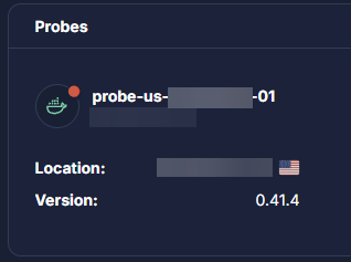

I set up my probe, but apparently, I’m not able to ping out:
Looking at the log files from https://dash.globalping.io/ , I see this:

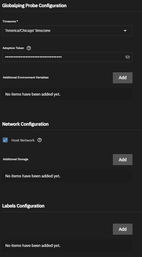

My TrueNAS Docker configuration is as follows:
What am I missing here?
GitHub created: [Bug Report]: Globalping-probe: IPv4 ping test unsuccessful - ping: socktype: SOCK_RAW · Issue #3814 · truenas/apps · GitHub
A patch was rolled out by TrueNAS apps team to resolve this issue.
