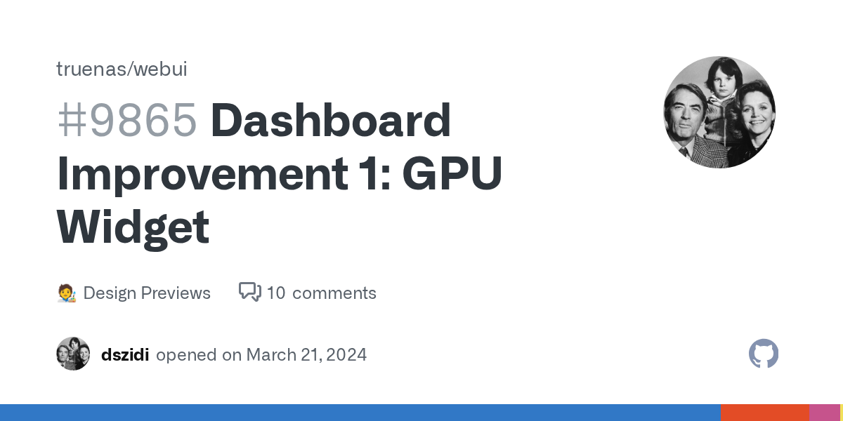

Almost 2 years ago the iX UI Dev team posted first drafts for gpu related dashbord widgets but there haven’t been any news on this
