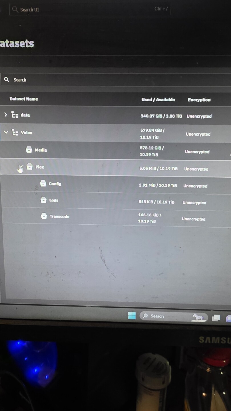

I created a dataset with apps permissions, with sub folders for Logs, Config, and transcode. Then in system configuration in plex I set all folders to Host Path on the system Data points to Video/Media. Logs points to Video/Plex/Logs. Config Points to Video/Plex/Config. And Transcode points to Video/Plex/Transcode I did not check enable Permissions on any.I also set my timezone and copied in my Plex claim code.When I go to the web UI the server is there, but no files are found.
