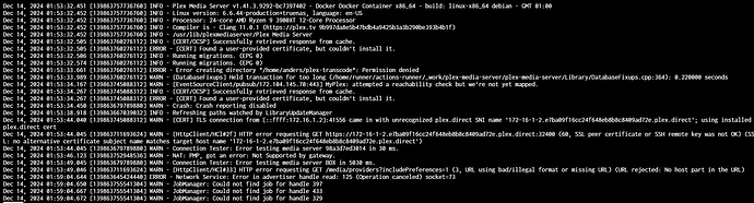

This is what I’m seeing in the PMS log:

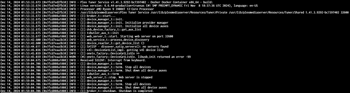

While I do not have a TV tuner card, nor have I ever had one, I also see this in the PTS log:

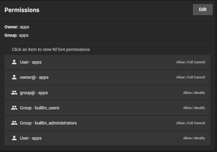

Currently the shares in question have been set up like this:
I made sure to reapply these permissions to all child members of the configuration dataset after installing my old config files by overwriting the ACL of all child datasets and their subfolders through the GUI. This certainly did something as it is clearly my server trying to start and not the vanilla server I briefly started to see that everything was working.

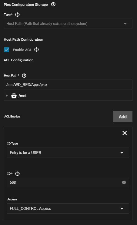

In the configuration for the plex app i have set user and group id to be 568. I have set up ACL for my mounted folders as follows (here just showing the config directory, but they are all the same except for the media directory where the user only has read access):
