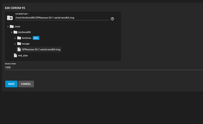

This what I see
as far as the advice not to use smb for these things, that seems fair – if it doesn’t work out the way we’re trying, I’ll take your advice
Then hit ENTER for the “bhyve sata DVD” …
nothing happens, it reloads the “page”
Ok, then try my suggested method to download and prepare the install image, please.
OK I did, here’s what I see:
This screenshot is from a friend of mine, who after entering “Boot from file” sees this, which I can’t see
You won’t be using boot from file. You want to set up and boot a virtual CD/DVD device. There’s something different with your setup of that one compared to mine I guess …
Aaaaah! Did you set the boot method of your VM to U(EFI)?
Exactly, doing otherwise would give me error
No, I was wrong. It still gives error, I attach it
No, EFI is the correct one.
I can only set it to UEFI_CSM and UEFI
Set it to UEFI.
