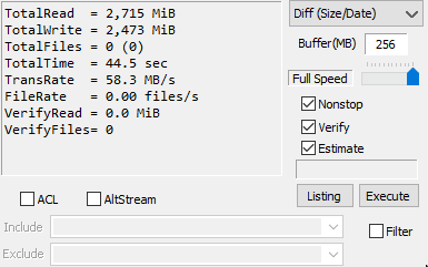

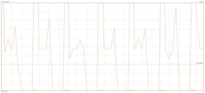

Test 1:
  1. Copy 33GB test movie from m2 ssd to unencrypted smb share on tank2
  2. Let Everything rescan only the encrypted image share on tank1.
The transfer starts out at 740MByte/s. Upon starting the scan, the transfer halts and then resumes at ~60Mbyte/s. So while there is hanging and a >12x slowdown, it’s not as bad as when I scan the music (>50x slowdown).
GIF:
testmovie to unencrypted, scan encrypted pictures

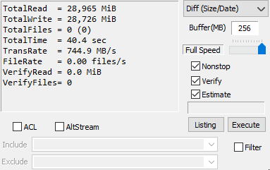

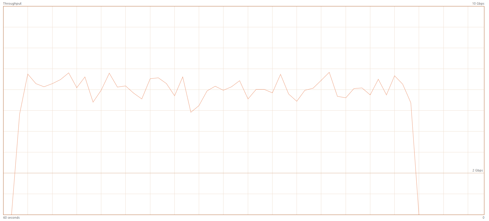

Looking at the load of the 10GBit NIC on my PC during that transfer while the scan is active it seems to only send bursts of data between windows of inactivity.
While the same transfer without anything scanning/traversing looks like this:

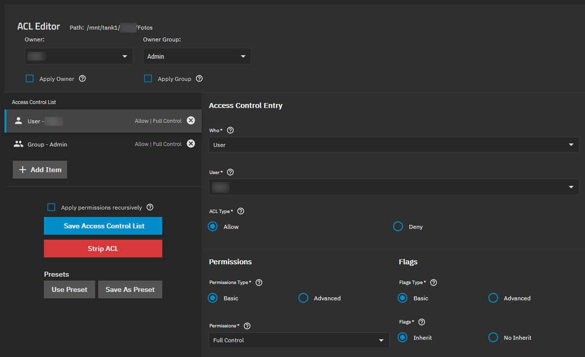

To note is that the image share has different permissions than the music share that I used for previous tests.
Only 1 user and 1 group instead of 1 user and 3 groups. This might also contribute to the different level of slowdown if it’s ACL related.

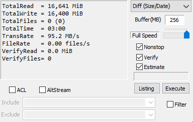

I replicated the images dataset from tank1 (encrypted) to tank2 (unencrypted), using these settings:
Replication speed:
grafik
This resulted in a locked encrypted dataset on tank2. After unlocking it with the passphrase, I set up a new SMB share of that dataset on tank2 with identical settings (default share parameters).

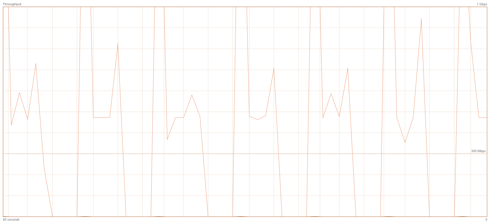

Then I repeated Test 1, but this time instead of scanning the encrypted images share on tank1 in Everything, I scanned the replicated version on tank2.
GIF:
testmovie to unencrypted, scan encrypted pictures on same pool
This continued to copy for a few seconds until it also started to hang and slowed down to next to nothing.
Result:
Replicated encrypted dataset on unencrypted pool tank2 yields similar performance issues as the original on encrypted pool tank1.

I created a fresh dataset on tank2, manually set the dataset properties and ACLs like they are on the image dataset on tank1 and copied the entire contents of the images dataset to it via rsync with these parameters:

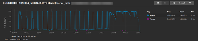

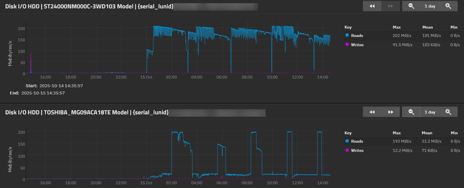

Might not be the (sole) culprit after all. The system has been online long enough to start the monthly scrub now.
tank2 = 8x 12TB WD, Z2, unencrypted, created on CORE
tank1 = 8x 18TB Toshiba, Z2, encrypted, created on CORE
tank = 10x 24TB Seagate, Z2, encrypted, created on SCALE

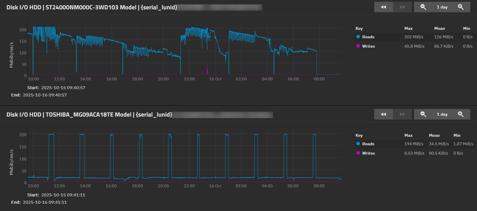

All 3 scrubs started at the same time at midnight on the 15th.
Here’s the load on one drive from pool tank (24TB Seagate) and one from pool tank1 (18TB Toshiba).

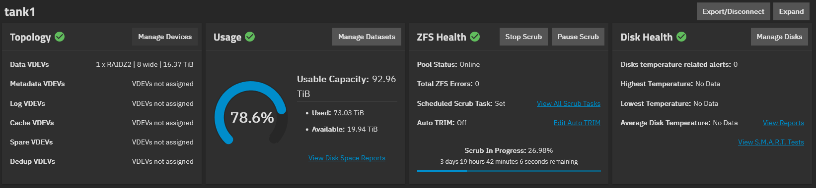

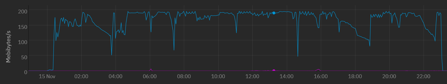

And this one is from today. The scrubs of tank and tank2 are already finished while tank1 is only at 26%.
The scrub on tank1 crawls along at 16-20MB/s read per drive, interrupted by 15 minute bursts of 190MB/s read per drive. Is there anything that could explain this weird scrubbing behavior? This pool was created on CORE 13.0 below U5.1 (don’t recall which version exactly) as ZFS encrypted. At first it held 2 unencrypted datasets (result of replicating from geli encrypted pool without turning on encryption) and was the reason I did not update the NAS (got an UI warning about unencrypted datasets in an encrypted root).
However before upgrading to SCALE I replicated those problematic datasets to tank and destroyed them on tank1.
Then I re-filled tank1 by replicating different datasets from a geli encrypted pool to it with encryption enabled in the replication task as well as replicating some datasets from another unencrypted pool onto it.
Correct me if this assumption is stupid, but could having used encryption in the replication task on already encrypted data (from a geli pool) made it hard for the NAS to access this data itself? That might explain why access on the majority of data is so insanely slow. And the bursts of normal speed would be from reading the datasets that were replicated onto it from an unencrypted source (or unused space). It’s 78,6% filled.
36TB came from unencrypted datasets on unencrypted pools, 35,5TB from a geli encrypted pool.
When this scrub eventually finishes I could try copying the content of the datasets that originated on the geli pool to another pool via rsync instead of using replication tasks (one dataset at a time I should have enough free space to do this), re-create the source dataset on tank1 and then copy it back to see if this resolves the issues. Thoughts?
This may be a fragmentation issue rather than an encryption issue.
At 1% highly unlikely I’d say.
The weird scrub finished without errors but took way too long (more than twice as long as on CORE).

aclmode?
Noticed that too so I changed it to “restricted” on the new dataset as well. The performance is still great so that’s not the issue.
