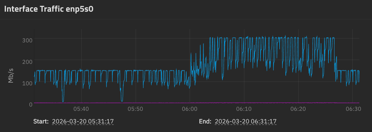

In a different thread in which I mentioned slow replication to my Hetzner server in Finland, it was recommended by @pmh that I try switching away from Tailscale to just using SSH. So I tried, and while with Tailscale I got:
with SSH I’m getting:
Which is both worse than Tailscale, and highly suspicious.

The graphs should be set to the same zoom level of time for comparison. Just changing that makes it look different. It’s just saying the image comparison could be better.
My apologies. I’m grabbing screenshots as I go.
Meanwhile, a second parallel replication just kicked off and completed:
So each replication session is throttled to 150 Mib/s. So no one is throttling in-between my servers.
