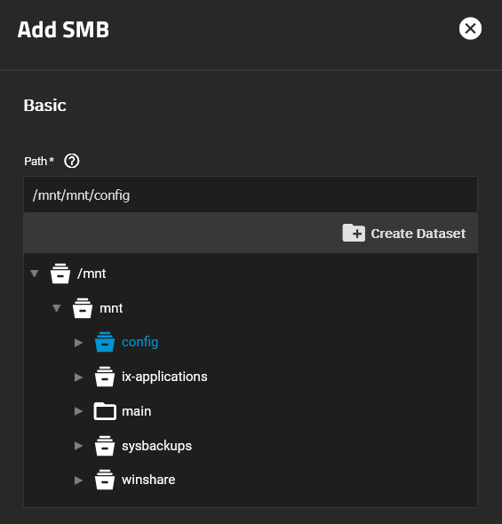

After getting a fresh install, nothing seems to have changed, I still have the datasets messed up and get errors such as this when trying to create a smb share.
[EINVAL] sharingsmb_create.path_local: The path must reside within a pool mount point
Not sure what really happened, and this is why tinkering with commands can land you in a pit.

Weirdly, it appears that the root dataset has been moved down a layer and a mnt dataset inserted as the root. Hence /mnt/mnt/*!!
